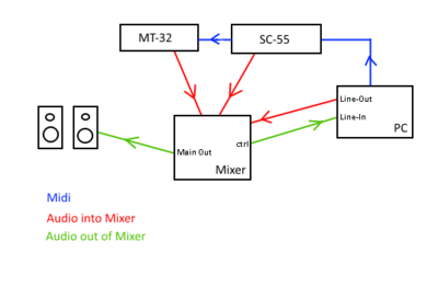

If you require the use of Line in, consider feeding it with a mixer or stereo selector box. It will simplify the task of changing between devices.
Reply 22 of 32, by Veloxi
Hey, if I did that, could I still use one USB interface cable along with the midi thru setup, or would each unit need its own USB interface?

Reply 23 of 32, by gdjacobs
As shown in the earlier diagram, you can daisy chain the midi cables and use one common midi output. This is a big reason to have an audio selector, as all the midi modules will be doing their best to interpret and play what's coming from your PC. They all have to be powered on to pass through midi data.

Ohhh, that looks great if I want to just play this through my speakers, but I also need to be able to record from this as well when I make videos for my YouTube channel, therefore I think I do need to use the sound card.
No problem, you have a "Control Room output" from the mixer which you connect to your Line-In and record your mix.

I'm trying to do the THRU method with my new SC-55 and I can't seem to get the THRU port to work with my MT32.
This is how it is connected:
Windows 10 PC -> Roland UM-ONE "To MIDI IN" cable -> SC55 MIDI IN -> SC55 MIDI THRU -> MT32 MIDI IN -> MT32 Output -> SC55 Input -> mixer\amp
I can hear the SC55 (it sounds beautiful!) but there is no activity on the MT32... it isn't showing any notes being triggered, and there is no sound. When I connect the UM-ONE directly to the MIDI IN on the MT32 it works perfectly fine with no other adjustments, running through the SC55's input to my amp.
Is there a way that the SC55 could be set to not use the THRU port right now? Are there any common problems with this method that I've missed? MIDI OUT on the SC55 doesn't seem to send anything to the MT32 either.
I think I've done a full reset on the SC55, so it shouldn't be an issue with old settings. I did the thing where you hold the instrument buttons while turning it on and it says "init all?", then hit ALL... I've also replaced the CR2032 battery and turned off the backup feature so that it resets on startup.
What could be happening here? I don't see anything at all in the manual about using the thru port, aside from the diagram showing that it exists.
EDIT: Oy... okay, so I thought I'd already tried this, but apparently only the REAR MIDI IN on the SC55 actually passes through the "THRU" port? That seems kind of lame. I had been using the front port to connect my UM ONE for use with my main PC (or with a midi instrument at some point), but intended to leave the rear MIDI IN connected to my DOS PC. What gives? Is this normal or is this something I can fix? I'd even be willing to modify the thing to make this work if that's possible.
If anyone who owns an SC-55 (non-MKII) could test to see if data sent to the front MIDI IN is passed to "THRU" on the rear, I'd appreciate it.

Ozzuneoj wrote:
...apparently only the REAR MIDI IN on the SC55 actually passes through the "THRU" port?
That's correct. Roland didn't make this point clear until the release of SC-55mkII though, where it's actually mentioned in the manual.
I would advise against attaching anything other than a keyboard controller to the MIDI IN 2 port on an SC-55. While the manual suggests that, "It makes no difference which connector you use when making MIDI IN connections," this has not been my experience at all. On the SC-55 models, the main CPU directly services the MIDI IN 1 port, whereas MIDI IN 2 goes through a separate, serial-to-parallel conversion process first. For some reason, this additional process results in the off-behavior of dropped and/or ignored MIDI messages in a congested MIDI data stream, and consequently results in off-sounding playback. With the later SC-55mkII, the MIDI IN 1 and 2 ports are both serviced by a separate sub-CPU, and behave equal to each other.
