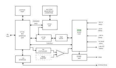

Reply 843 of 1053, by mattw
Maelgrum wrote on 2023-10-10, 20:51:
Don't see anything like some DAC check or init.
I found the following block diagram:
40.11 KiB
1207 views
AWE32 Block Diagram
So, it looks like the DAC data should be possible to be intercepted on an empty ASP/CSP socket, because they are passing through there - it will be convenient to solder on an empty ASP/CSP socket too.

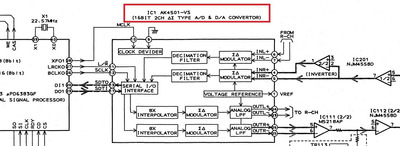

Reply 849 of 1053, by mattw
Maelgrum wrote on 2023-10-10, 22:58:
Yes, I am also can't find datasheet. But with oscilloscope, it is not hard to find all important pins - bit clock, bit data, and some form of LR word clock.
AKAI equipment uses AK4501 and the full Service Manual is available here:
https://archive.org/details/manual_TC890_SM_AKAI_EN
so, all the pins are actually known.
[EDIT] and here is the AK4501 schematic taken from the above aforementioned Service Manual:
119.28 KiB
1098 views
AK4501 Schematic
[EDIT2] found even more equipment with Service manuals available that uses AK4501: "Sony MZ-E30" and "Yaesu FT-1000 MP". so, yeah, AK4501 pinout is well available.
[EDIT3] it seems on all those old Akasi-Kaisei DACs the I2S input interface is pins 11, 12, 13 and SDTI signal is either pin 17 ( AK4501 and AK4510) or pin18 (AK4503) - in other words AK4501 is basically the same as AK4510 on the Yamaha WaveBlaster board:
Re: DB60XG / XR385 repair and modification
and more or less the modification should be similar if not exactly the same.

Reply 853 of 1053, by Maelgrum
mattw wrote on 2023-10-11, 00:12:
You miss one little detail - sample rate on SB is variable, while on Wave blaster it is constant.
So in SB case, sample rate converter needed.
[Edit] Even if SB16 outputs samples with constant rate, it will be something like 45522.65625*x Hz, so sample rate converter is also needed.
