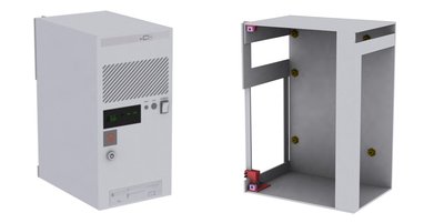

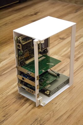

Reply 22 of 37, by adalbert

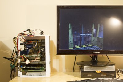

Here are my attemps on making miniature ATX and AT cases, + links to related topics
Re: Adorable 1/3 scale Macintosh
Re: Little Voodoo (cardboard) Box [P1] + 486 with small DIY AT case
Re: What retro activity did you get up to today? detailed photos of 3d printed mainboard standoffs
both cases currently are "open-style" as I didn't make any panels yet, but eventually I will finish them.

Reply 24 of 37, by adalbert
Oh, that's you. You have probably already seen that 🤣 i will try to make the front panel maybe this or next weekend, I got some new blank HIPS sheets, I just need to cut them and maybe 3d print some details.

Reply 27 of 37, by adalbert
Currently I'm not using anything else for my retro projects, they are quite good. I didn't experience serious problems, you just have to remember not to overload those PSUs. When too much power is drawn it gets hot, some interference on screen might be noticeable (due to voltage ripple) and the PSU will automatically shut down because of temperature. Such problems may happen on that smaller PSU, with AGP video cards stronger than GF3 Ti200, or cpus like Athlon. But the larger PSU is pretty powerful. So, to sum up, you can run 486 or P1/K6 on basically anything, but select adequate power supply for something more powerful. If things get too hot, capacitors can slowly dry out, and stability will be worse.

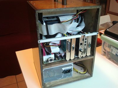

Reply 29 of 37, by mongaccio

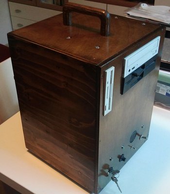

First of all sorry for my poor english,it is rare for me to write in this language.
Well, i had a bunch of Pci and Isa cards sitting in a box.Also a nice Abit Pb4 motherboard (really tiny 486 MB) which i recently upgraded with a PnP bios.
Problem is i still don't have any pc case available for such old hardware and i do not want to put stuff from '95 into modern cases.
That's why i have decided to build a wooden case.
Handle is made by my father.Good Lord he has this urge to put handles on everything 😀
130.67 KiB
837 views
The big flip button and round reset switch come from an old helicopter cockpit, the keylock mechanism from an old cash register.
Leds have their little circular metal encasement, scavenged from old and broken equipment.
Making right and proper measurements was the hardest part, doing perfect rectangular holes for floppy drives it's quite the hassle!
10 layers of 'wood finish' and a nice glossy effect is added to wood.

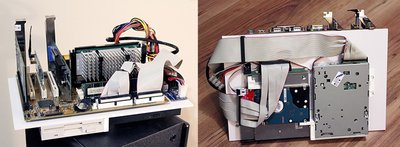

250.93 KiB
837 views
Here's the back. I opted for Compact Flash because i'm scared to damage old hard disks and reinstalling everything 😀
It's a bit cramped but everything fits! Lower level dedicated to power supply (atx with at adapter and switch), leds and buttons.
Upper level occupied by Motherboard, peripherals and expansion cards: Cirrus logic pci with 2mb ram, 3com isa lan , ess 1868 audio.
I really like ess 1868 midi !

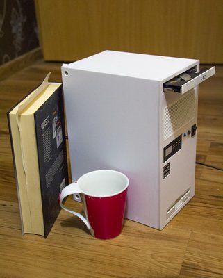

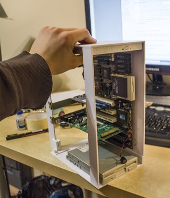

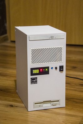

Reply 36 of 37, by adalbert
All right, so my micro AT case is almost complete 😀 just need to 3d print the turbo button, add the stickers with names of buttons and improve some connectors in the behind of case.
243.32 KiB
632 views
266.23 KiB
632 views

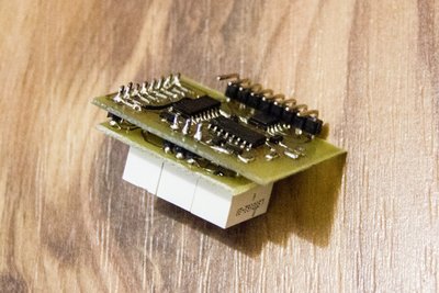

I made a LED MHz display using a Atmel ATTiny13 microcontroller so it's programmable and doesn't require messing with jumpers 😉
