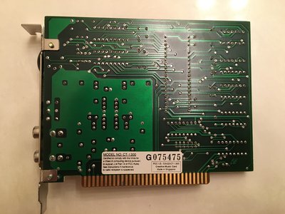

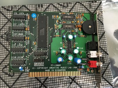

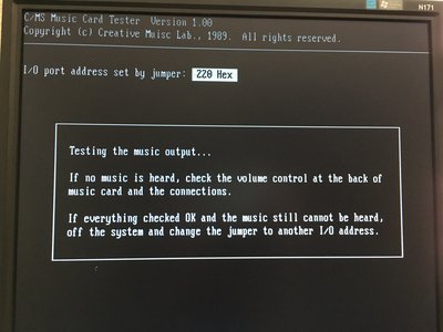

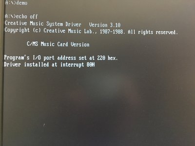

Revisiting this, sadly this beautiful card is still not working, I could use some guidance as to its repair. Card freezes the system during the TESTCARD and DEMO programs at the sreenshots below. CRTL+ALT+DEL will not reboot the system once this happens. Can hear quiet noise through the outputs, which sounds normal. Have tested on at least 5 systems, a few XT's, 286's. I have tried all HEX addresses. Ideas?

Reply 3 of 10, by squareguy
I cannot tell directly from this picture but blue electrolytic to the right of C13 is suspect. It is leaning a good bit which may mean it has built enough pressure inside to start pushing the rubber plug out of the bottom.

Reply 4 of 10, by Jepael
It looks like it's in pristine condition.
So you hear something, like just noise or faint music sound even?
Maybe the volume pot is crusty and needs cleaning? Have you tried just adjusting the volume up and down several times to clean the pot a bit?
Or maybe the ISA connector needs cleaning? It does look very good to me, but some contacts do have some oxidation on them.
Other than that, usual procedure of fixing things is to debug what is wrong with it and then repairing it.
What I mean is don't blindly replace the caps, the odds are it won't fix it.
It would help if you have access to an oscilloscope, so you could systematically probe what works and what doesn't.
Since you only hear some noise, it appears the amplifier chip is OK, so maybe the CMS chips don't output audio, maybe it does not see writes from ISA bus.
Or maybe just the pot is broken so audio is cut between CMS chip and amp.
Reply 5 of 10, by Formulator
Jepael wrote:
It looks like it's in pristine condition. […]
I think the pot is ok, the noise floor moves smoothly with the dial. What is interesting is how the system locks up when audio playback is attempted.
Reply 6 of 10, by Great Hierophant
Does it lockup when you try games?
You don't have an Adlib driver like ADLIB.COM or SBFMDRV.COM loaded as well by any chance? Any driver that assigns itself to INT 80H might cause a crash.
Reply 7 of 10, by Formulator
Yes, it locks up with games, I first tried with Revenge of DOH. Some of these systems had a CT1350B in there, but I pulled it and removed the text from AUTOEXEC. I am curious as to what causes the driver to assign itself to INT 80H.
Reply 8 of 10, by Jepael
That's good info! There is a rumour that says when you try to write to C/MS chips that are not installed on old Sound Blasters 1.x cards the PC will hang. This is because writes to C/MS chips are slow there is circuitry to trigger on the IO write and it will trigger a signal towards the ISA bus to add wait states to an IO cycle, and this signal is removed when the C/MS chip indicates it has gotten the write.
So when the C/MS chips are not installed on SB1.x (or not responding), the wait states are added up to infinity and PC hangs. Some people say it should not hang because there is supposed to be a timeout so that a device cannot hold the bus cycle for too long.
(I'd try this, but my SB 1.5 has the C/MS chip soldered on, not on sockets).
My next question is, can the games and demo programs detect the presence of the sound card and its address automatically?
If so, then at least half of the card is working, but the sound chips may have some issue.
Also, if possible, remove the CT1350B when doing these experiments. I think the PAL chip on CT1350B missing prevents the ISA bus hold circuitry from working, so trying to access C/MS chips on CT1350B does not hang the PC. And obviously the sound cards need to be in different base addresses to work. The point being, the games look for a Creative card from all base addresses and it's usually from address 210h onwards. There may be differences, but they might first detect if it is a CMS card or SB card, and they will usually settle for the first card they find.
Reply 9 of 10, by Formulator
Interesting, I do have a CT1350B with the socketed C/MS chips. I wonder if this experiment would work with the C/MS jumper open and the sockets removed. Probably not, but worth a try.
Reply 10 of 10, by h-a-l-9000
Rank DOSBox Author
DOSBox Author
Measure the voltage on pin A10 (I/O CH RDY) of the ISA bus when the computer is stuck. If it's logic low the system was hung by the wait state cirquit.
The electrolytic capacitors cause no/bad sound when defective but will not freeze the system.
