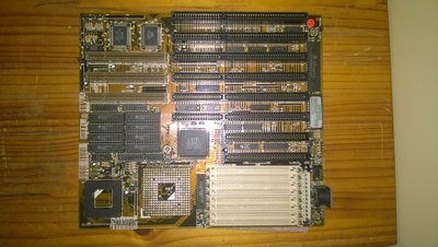

The motherboard in this picture comes from the first PC that I bought for myself.
2.15 MiB
1958 views
3/486 VL motherboard
It's a hybrid motherboard that caters for both 386 (including Cyrix DLC's) & 5v 486 CPU's.
However, I'm curious as to who the manufacturer of this motherboard is.

I'm bumping this thread of mine since I've had no luck in tracking down the BIOS for this particular motherboard (the current BIOS has died on me).
Since this is a Jetway motherboard, I'm hoping that someone else on here might have a similar Jetway motherboard with an AMI386DX BIOS.
The BIOS ID for Jetway is 1276, which will be the third set of numbers in the BIOS ID on the start up screen.
The AMIBIOS string for this motherboard should be something like this: 40-0802-001276-00101111-080893-OP495XLC-H
If anyone has a similar motherboard, I would appreciate a BIOS dump.
There is no need to remove the BIOS chip - a simple utility called Navratil Software System Information (NSSI) has the ability to dump the motherboard BIOS.

@PcBytes - I have tried numerous Opti 495XLC BIOSes from different manufacturers and the board wouldn't post.
Recently, I acquired an A-Trend 3/486 motherboard (same chipset) and that worked but, it gave me errors in terms of my secondary cache - EDIT: turns out that, at some point, I swopped out the cache RAM chips and forgot to set the jumpers accordingly. So, the A-Trend 3/486 motherboard BIOS does actually also work with the Jetway J-402B motherboard.
I also recently tried out the MR BIOS variant for the Opti 495XLC chipset and that one worked.
But, having the orginal BIOS is my preference.
EDIT: Tested out the BIOS and it works perfectly. All the BIOS settings matches what is in the manual as well.
