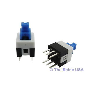

Some good news! Those little 8mm self-latching switches I ordered a few posts up (thanks for the idea TheMobRules) were a perfect drop-in replacement for the existing switches on the front of my case. I took a spare jumper wire, soldered one switch to it, plugged it into Reset button, plugged the other into the turbo header, and poof! My reset button becomes a turbo button! Did the same with the power switch coming off my AT-ATX power supply adapter. So now I can close up my case finally. 😀 Power button=power button; reset button=turbo button. Sweet! Still no I/O shield, but I don't care about that, as I can't see it. 😉

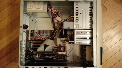

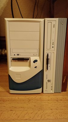

Here is the final build.
879.27 KiB
851 views
486 on the left. Packard Bell on the right is my Pentium Overdrive 200MMX

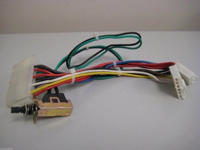

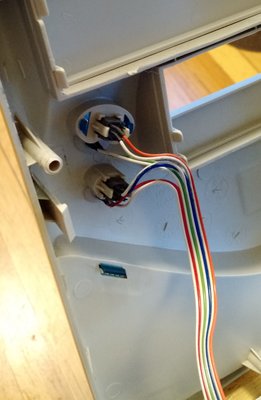

I forgot to take pics of the switches after I modified them, but basically I cut the green and black wires to remove the big mechanical power switch off of the AT-ATX PSU adapter.
100.76 KiB
849 views
ebay photo
I soldered the green and black wires to the latching power switch.
6.95 KiB
849 views
latching 8mm switch
I used the existing momentary switch as a template. So the green wire went on the upper left pin and the black wire went on the pin right below the green. To orient, there is a little hole on the bottom of the switch. Hold the switch so the hole is at the top. Green is on top left pin, black on the middle left pin. Once the soldering is complete, just replace the existing case switch with the new one. There are two clips on my case that hold it in place.
579.96 KiB
849 views
I did the same thing for the Reset button below the power button. I got a spare jumper wire from another case and soldered to the latching switch in the same orientation (colored wire upper left, white wire middle left). Dropped the switch into the reset button location, plugged the jumper into the turbo switch header on the motherboard.
Edit: just to note, now when you push the power button on the front of the case, the button stays in a recessed position due to it being a latching switch. Same with the reset button. It stays pushed in when you engage turbo.

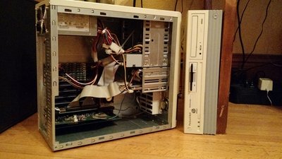

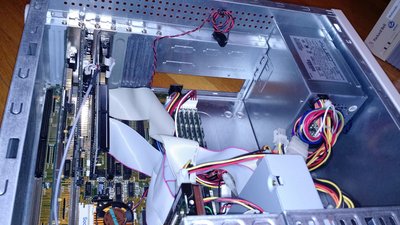

Here's some more photos of the Pentium MMX machine, including some lovely internal shots.
Souped up Packard Bell
I really like having it on my desk with the monitor on top, but it takes up too much room, so I moved it to the floor. 🙁
