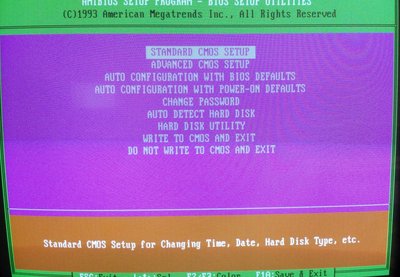

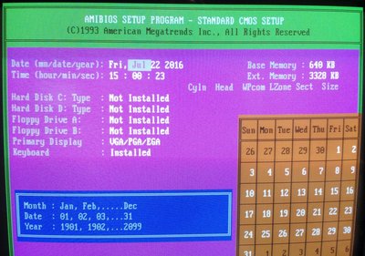

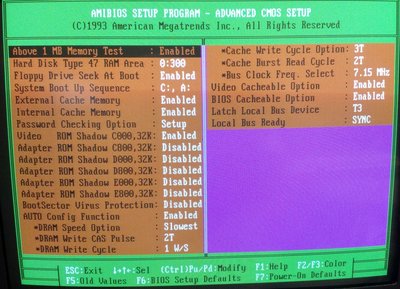

Here's what the BIOS screens look like. Any suggestions for altering any of the existing settings?

Reply 28 of 72, by Jo22
Looks good! Maybe enable a bit more Shadow Memory. Perhaps it can then be used by HiRAM. Depends on the chipset..
Reply 29 of 72, by brostenen
Just out of quriosity. Does this have any relationship to EMM386?
I have noticed that on some motherboards, you get an frozen system, when using the line "DEVICE=C:\DOS\EMM386.EXE RAM HIGHSCAN".

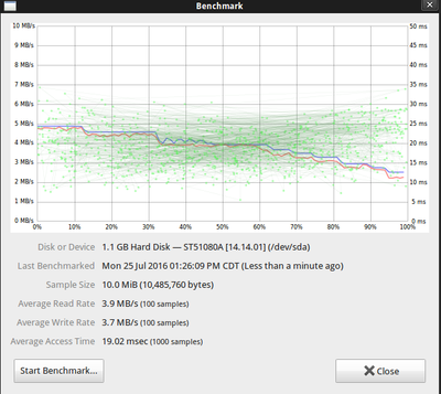

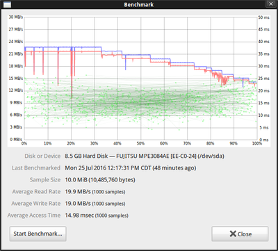

While I wait for the I/O controller, I'm testing a couple of hdds that are candidates for this 486 system:
8.4GB Fujitsu MPE3084AE
1.0GB Seagate ST51080A
The Fujitsu has 85 bad sectors and 7.4 years of power on time (64998 POH). It passes all maintenance tests (even SpinRite Level 4) I throw at it except for POH (linux smartmontools fails it automatically if it's over 5 years). Performance (in a modern system):
134.48 KiB
483 views
Fujitsu MPE3084AE
The Seagate does not support SMART, so I can't glean POH or any reliability data from it. However, it passes SeaTools Long Test with flying colors, as well as SpinRite level 4 scans. Here's its performance profile in a modern system:
143.85 KiB
483 views
Seagate ST51080A
Without knowing the POH on the Seagate, nor knowing if it's ever had any bad sectors, it's a tough call. I tend to go with the Seagate because it is closer to period correct, being a 1995 drive. The Fujitsu was mfg in 2000.
Plus, the I/O on this system will be the bottleneck for both drives, so other than access time, the two drives should perform similarly.
Fun stuff. 😀

Reply 34 of 72, by Jo22
brostenen wrote:
Well, yes and no. By enabling Shadow Memory, you can "flood" a specific region with RAM.
This can be handy to copy the system's BIOS, the VGA BIOS or any other firmware from ROM chip into the faster RAM (your BIOS has separate settings for that).
However, EMM386 doesn't need that to work. It uses the Memory Managment Unit (MMU) to map extended memory into the Upper Memory Area (UMA)
and creates upper memory blocks which DOS can use (UMBs). And it also provides EMS if you wish.
This works fine most of the time, but EMM386 also switches the processor into V86 mode.
And EMM386 also requires some memory for itself and it is stressing 386/486 chips a bit.
Alternatively, you can also have UMBs without EMM386 loaded.
If Shadow Memory is enabled, you basically have UMBs in "hardware".
However, there's a drawback: The memory is still write-protected.
By using a special chipset driver or the "HiRAM" package you can make it writable.
These drivers also have another function: They mark these UMBs as "free", so these regions of memory can bee seen and used by DOS.
Or in other words: It's similar to UMBPCI, just for older machines (286-486) without PCI. ^^
I hope you understand what I mean. I'm a bit tired today and my wording is poor.
And maybe some of the things I said are aren't entirely right, dunno.

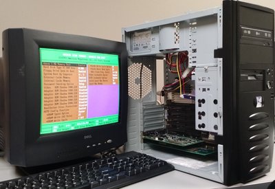

While I wait for the I/O card, I thought it would be fun to play "dress up" with my 486. 🤣. Stealth Mode...Engage!
214.62 KiB
393 views
I will probably move it back to the beige case, but wanted to see how the 486 looked in black.
Reply 36 of 72, by brostenen

Reply 37 of 72, by brostenen
It actually does not look bad. All you need now, is to blank out that empty space were the ATX shield goes.
Reply 38 of 72, by PhilsComputerLab
Rank Hardware Mod
Hardware Mod
Looks very nice. Black CRT too...

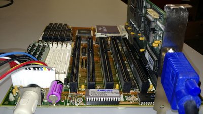

I've been meaning to ask, was it fairly common for BIOS chips to block ISA slots? It seems all my ISA cards will not seat fully in slots 2 and 3 because of the AMIBIOS chip there.
38.48 KiB
380 views
