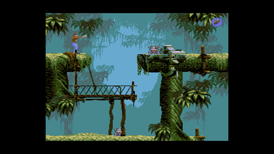

Flashback does not look right?
wrote:Flashback does not look right?
Now it does. I had bug in my code. Notice that on your monitor it is displayed with 5x4 pixels, for the its calculated aspect ratio is 0.857 vs. the 1.000 that DOSBox assumes. EDIT: The question is: is it better or "truer" than the 1:1 ratio?

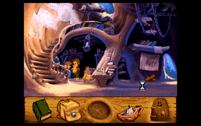

Once upon a Forest looks great.

Flashback was originally an Amiga game, which runs in a PAL resolution of 320x256, so a different aspect ratio than what you'd have on PC. So it always looked a bit 'stretched' vertically on PC.

Regarding the native pixel aspect ratio of Flashback:
wrote:Flashback was originally an Amiga game, which runs in a PAL resolution of 320x256, so a different aspect ratio than what you'd have on PC. So it always looked a bit 'stretched' vertically on PC.
If they did not scale or redraw the GFX for MS-DOS but chose to display the same pixels in the smaller area, then the game should look wider in MS-DOS:
A pixel's width relative to its height is:w_p = 4/3 * height / width;w_p_amiga = 4/3 * 256/320 = 1.07w_p_msdos = 4/3 * 224/256 = 1.17
wrote:https://www.youtube.com/watch?v=KVni0T7cEOk looks like this, i guess
Thanks for this link to Flashback running on a real Amiga. As Scali noted, Flashback for Amiga used a different graphical mode, so it cannot serve as a reference because we wish to emulate the way the game looked on MS-DOS, do we not? Can we ask this of some real-hardware fellows here at vogons? I can prepare two perfectly scaled versions of the same screen when I get home.
