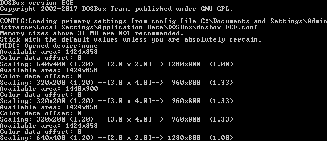

Attached is the requested screenshot. Notice the native resolution is 1440x900 and I'm going from windowed to fullscreen and back.
I see:
Available area: 1424x858
rather than 1440x900. I suppose the smaller figure is the size of your window, because in fullscreen the available area should be 1440x900, but I did not find it in the screenshot...
Here's the thing: a 320x200 picture AR-corrects to 4:3 perfection at 1600x1200, but proportionally downscale that 1600x1200 to 320x... and you get 320x240
That's right, but you do not have 1600x1200, so the patch cannot reproduce the aspect ratio perfectly. Notice that it must use integer scaling factors in order to keep the image pixel-perfect. It therefore chose 3 and 4 as horizontal and vertical scales respectively, which resulted in a pixel aspect ratio (PAR) of 4:3 or 1.33, vs. the target (perfect) PAR of 6:5, or 1.2. What should you expect (or desire) my patch to do instead? If you would prefer to have square pixels (unity PAR), just disable aspect-ratio correction in the config file.
Don't mind the windowed mode. I just mentioned it so you could relate more reliably to information on the screenshot. I always use fullscreen if the software allows it; I detest having anything windows show up in my dos fov.
