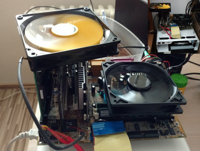

Here is a picture of my S370 setup with DUAL FAN cooling system, just as an idea 😊

^^^least it cools the ram as well

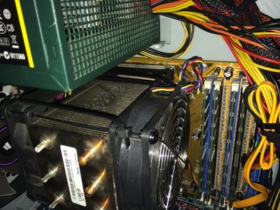

As for the socket 478 I did this to my one computer I call blackmagic and overclock the crap out of it, but i would like to find a better way of doing it then this...
