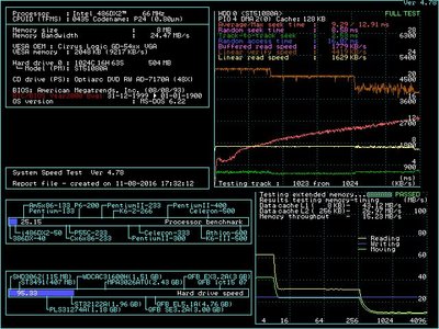

First up, default settings Speedsys:
83.36 KiB
1696 views
Default BIOS Timings
Memory bandwidth: 24.47MB/s
L1 Cache: 43.12MB/s
L2 Cache: 26.97MB/s
Memory Throughput: 15.23MB/s
Doom: 24.19fps
Quake: 6.7fps
3dbench: 42.0
PCPBench: 9.0

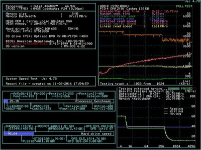

Next, fastest BIOS timings:
82.88 KiB
1696 views
Fastest BIOS Timings
Memory bandwidth: 37.21MB/s
L1 Cache: 55.93MB/s
L2 Cache: 41.08MB/s
Memory Throughput: 23.99MB/s
Doom: 27.05fps
Quake: 7.5fps
3dbench: 46.1
PCPBench: 10.5
Really interesting is comparing the memory/cache timing graphs in the two Speedsys screenshots.

Reply 3 of 8, by elianda
VLB System with a typical 3-1-1-1 0/2 WS config:
A PCI system:
WT is faster with a 66 MHz 486er than WB with most games.
Youtube Channel
Reply 4 of 8, by clueless1
In your VLB system the memory bandwidth is so much higher than mine, but the results in the lower right graph are nearly identical. Maybe 72-pin vs my 30-pin memory?
