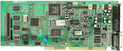

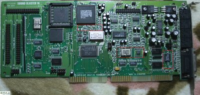

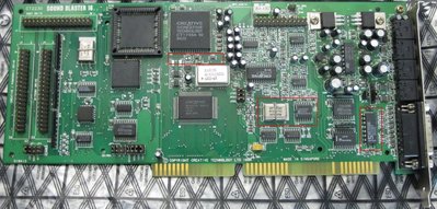

There are at least THREE revisions of the CT2230 I know of, all can come with DSP 4.11 or 4.13, CT1745A or CT1745A-S.
* Oldest to newest, by bottom left codes.
019413
481.17 KiB
2448 views
029417
438.16 KiB
2448 views
049432
511.45 KiB
2448 views
If you got a CT2230 49432, DSP 4.13, and CT1745A-S mixer chip, you're lucky.

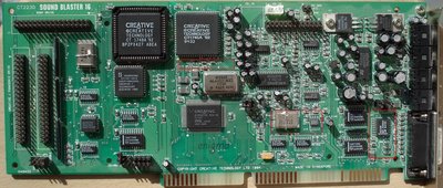

Take a look at the CT2290 revisions which are basically a further upgrade of the latest CT2230 (49432) with the IDE controllers stripped.
