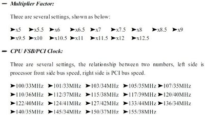

Reply 5 of 6, by melbar
What a pity! Would be bad that i can't use FSB133 with this KT7 board.
The manual of KT7/KT7-Raid/KT7A/KT7A-Raid, it's a manual for all 4 variants of these Abit boards, i've linked previous mail, there is at page 40 shown all the users defined setting.
You mean this is valid/available only for the KT133A chipset?

Reply 6 of 6, by Imperious
That's right, 133fsb only works on KT133A chipset boards. As I mentioned the only way to get higher multipliers is to mod the cpu socket. I doubt the fsb increase itself
does much for performance as the sdram even at 133mhz becomes a bandwidth restriction at higher cpu speeds. Over 2ghz on the cpu gives barely noticeable
improvements. I don't have a ATI x800 video card, but so far a Radeon 9800xt gives higher benchmark results than a 6800gt.
A motherboard with ddr ram support is what these cpu's need. But I enjoy running hardware on a motherboard that wasn't possible back in the day.
