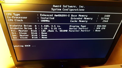

I've recently purchased from eBay Lucky Star LS-486E combo with AMD 486DX4-100 CPU and 32mb of RAM. As I only have one old 80MB IDE HD at my disposal, I've decided to use IDE/CF Adapter with 4GB CF card as my primary HD. Configuration is able to boot with old Maxtor 80MB hard drive into DOS, however every time I try to boot with CF card I'm being stuck on "Updating ESCD" problem...
I'm not sure if problem is CF card, cache memory or something else (BIOS configuration). I was able to install MSDOS 6.22 when booting from floppy drive. CF card was formated successfully into 2 partitions (primary and extended), installation went without a problem. Once I removed bootable ms-dos floppy, I would be again stuck on Updating ESCD" problem... Pictures attached.

Booting with CF card:

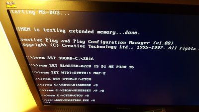

Booting 80MB HD with installed MSDOS:
Reply 1 of 2, by TheMobRules
Try booting from the DOS installation floppy, exit to the command line and type:
fdisk /mbr
For some reason when DOS is installed on a CF card you generally need to rewrite the master boot record afterwards, or it will get stuck trying to boot from the CF.

Fixed, it works!!! Thanks 😀
