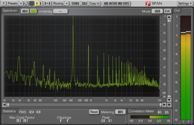

To actually measure the spectrum you have to use a VST spectrum analyzer plugin, and a sound card which has quieter inputs than the subject under test (important!).
You can use SAVIHost to load a VST plugin without having a full blown DAW software, make sure you set the sound card input (Devices->Wave).
Voxengo SPAN is currently the best freeware frequency analyzer which I and countless others use.
http://www.voxengo.com/product/span/
229.51 KiB
2992 views
128.07 KiB
2992 views
Use the settings in SPAN I provided for accurate reading.
Block size makes the analyzer more accurate but slower.
Slope has to be zero for flat reading of the white noise.
RT Max, for real time reading.
Red arrow is where you take the noise floor reading when not playing anything.
Blue arrow is where you take the Peak reading when playing the 440_odb.wav file with Mpxplay.
Do a subtraction (delta) to get the SNR value.
To maximize signal to noise ratio you have to play with the SB mixer.
Typically, raising the WAV (SB) volume does not raise the noise floor, but the AUX (wavetable) does.
The MASTER volume raises the noise floor and might created distortion at high volumes.
The 440_0db reading should be pure as possible, if you see other frequencies there is distortion.

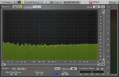

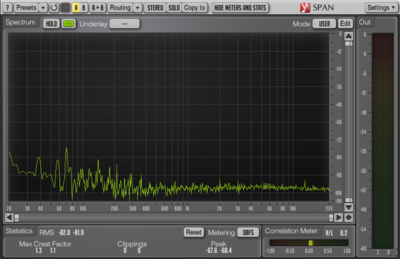

Here are readings from the ES1688 in SBP mode:
Noise floor:

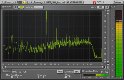

Equal frequency White Noise:

The input noise floor of my audio interface is 20db lower (-102db RMS) than the noise floor of the ES1688 (-82db RMS) so it should be fine for testing.
In the first picture of the noise floor you can see more noise in the lower frequencies which it typical for old sound cards and PCs.
Second picture you can see the ES1688 has a steep lowpass filter at 10k.
In the last picture you can see some harmonic distortion along with the pure sine wave, you can also see the peak db reading.
Subtract Peak 440 from RMS noise floor to get signal to noise ratio (SNR).

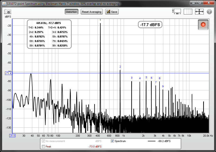

Another excellent program to analyze the spectrum and show the THD+N is REW (Room EQ Wizard):
0.07% odd harmonic distortion is nothing I would worry (or hear) about, especially in SBP mode where the 8bit noise is high.

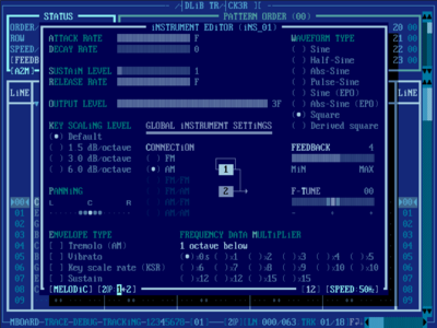

In the name of better understanding I used Adlib Tracker II to manipulate the ESFM and OPL and test the difference of the feedback behavior.
There are 7 levels of feedback in the OPL chip with each wavefrom, so I have recorded all 7 on Square and Sine with the ESFM and Nuked-OPL*.
The Operator configuration is set to parallel with #2 (Carrier) being completely off, so you hear only one Operator (Modulator) with various feedback levels.
* The Nuked-OPL is a bit perfect emulation of the YMF262 made by nukeykt.

Inside the ZIP there is an ESFM folder with 0-7 wav files, and a OPL folder with 0-7 wav files.
Square:
0 sounds identical between the two because there is no feedback.
1-3 gradually beginning to sound different on the ESFM to OPL.
4 is where the Stunts track from the first post would be, still musical on the ESFM but barely on the OPL.
The biggest difference is 5, it sounds completely broken on the OPL but quite good on the ESFM. 😐
6-7 also sound identical between the two because the feedback is so large there is practically no sound difference.
Sine:
0-3 sound identical.
4 beginning to sound different.
Again 5 is where the biggest difference is, on the OPL there is nothing but a thin glassy hiss, but the ESFM is much more musical.
6-7 have little difference in noise.
Conclusion:
The ESFM has a slightly different feedback distribution curve than the OPL.
In most cases the OPL sounds thin and buzzy/glassy with high feedback levels but the ESFM retains a more pleasant musical sound across all feedback levels.
I certainly don't mind the difference with DOS games that the ESFM produces (rare as they may be), in most cases it sounds even better (blasphemy I know). 😀
The reason the difference is so small in games is because the developers did not like/use the buzzy/glassy sounds produced with high feedback except for noises.
I guess this thread puts the nail in the coffin for the great ESFM vs YMF262 mystery, and allows the user to finally hear for themselves and decide if the ES1688 is good enough for dos gaming.

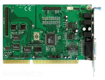

Very interesting. I am actually going to be building my 'final' time machine in the foreseeable future and I just grabbed one of these cards for $20 shipped. It looks exactly like the one you have. I really want to inspect its layout and remove the two LM386s and replace them with a low noise opamp for even less noise.
EDIT:
this is the card
443.05 KiB
2456 views
