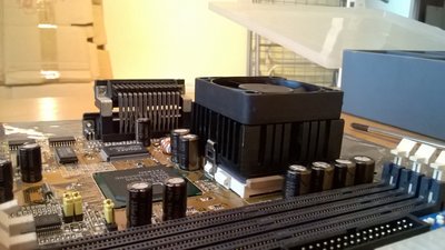

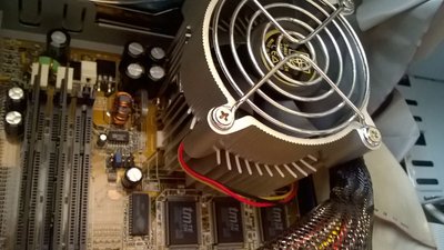

Reply 2 of 19, by brostenen
Heatsinks were mandatory on Amd 486dx2-80, and they suggested them on dx2-66 and passive one were sometimes used on dx33. The pictures I am posting are all of SS7 motherboards.
EDIT:
For thermal paste, you can use everything from the cheap white stuff used around 2004/05. To that silver based stuff.
Does not really matter. Only you'r wallet set's the limit.
    82.83 KiB
    1256 views
    FIC PA-2013 and K6-III-400 with a huge Athlon Socket-A cooler. (This one has cobber core)
    125.14 KiB
    1256 views
    Gigabyte GA-5AX and K6-III-400 with a 60mm P-III cooler from Startech.com
