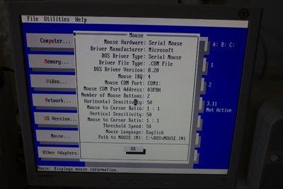

After putting the motherboard into the case, installing new RAM, and switching around the cards a bit, now my mouse doesn't work.
The mouse is a serial Microsoft mouse that definitely worked with the same motherboard and I/O ISA card before I put it in the case. While working on the board I might have switched around the positions of the ISA cards etc. Don't really remember how it was.
So: I plug the mouse into COM1 on the multi I/O card. MOUSE.COM detects it fine, MSD.EXE shows correct-looking mouse info, and the mouse pointer shows up:

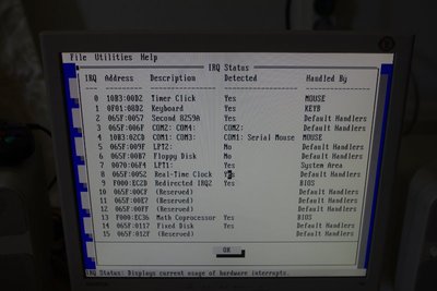

However, mouse is immobile. Can't move the pointer. So I check the IRQ settings and this looks really weird:
78.51 KiB
348 views
Why would it show IRQ 0 as being handled by the mouse driver? Isn't this wrong? What's going on here? What should I do? Honestly, don't know where to even start with troubleshooting this. Help appreciated 😖
Reply 1 of 6, by Tommaso72
It looks to me your serial mouse is on IRQ 4, but I could be wrong. The confusing part is it comes up in two places, so good question. I would think IRQ 4, but may be someone more knowledgeable can answer why it shows up in too places. Sorry I can't be of any real help.
Tommaso
Reply 2 of 6, by TheMobRules
Maybe you could try a different mouse driver? It seems that the MOUSE.COM you're using also registered itself to handle the system timer interrupt (IRQ 0)... very strange. What does the diagnostic program show in IRQ0 if you do not load any mouse driver?

Reply 6 of 6, by nforce4max
einr wrote:
Thanks for all the replies!
Turns out all I needed to do was re-seat the I/O controller. That's a little embarrassing. Sorry. 😊
