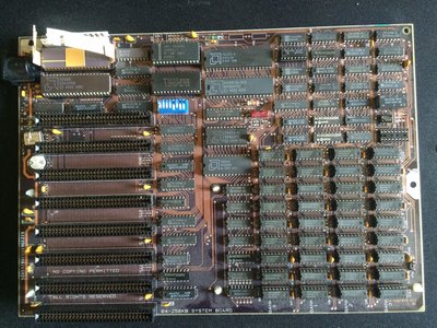

One XT motherboard with an AMD processor and an Intel coprocessor (why?). Can someone identify this board? It looks like a clone board since I don't see IBM anywhere on it, but some of the chips are labeled IBM, so I don't know. It also appears to have all 256K of RAM 😀

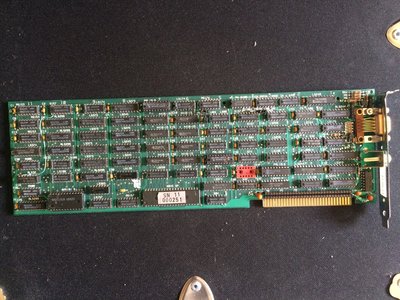

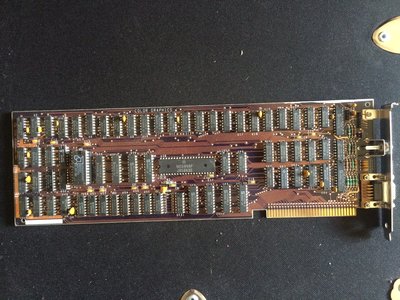

One CGA graphics card with the Motorola chip. Is this an original IBM card? I can't tell.

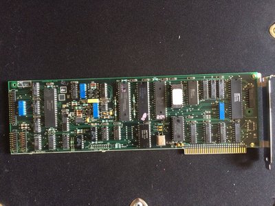

Some kind of controller card? Really, I have no idea what this is. There's no port on the backplate.

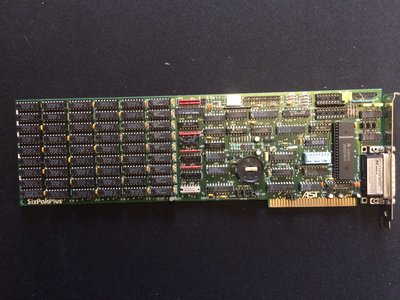

What is this, a combination parallel/RAM card? And if that's RAM on it, how much is it?

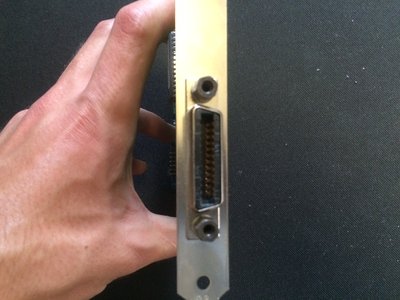

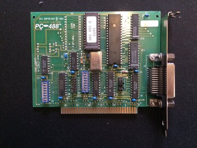

I am at a loss as to identifying this one. What on earth is that port?

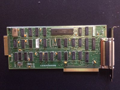

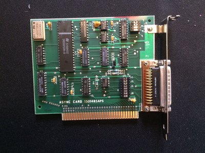

And this appears to be a parallel port card; correct me if I'm wrong.

I'm not enirely sure, but I think x87s were only made by intel in the early years.
Or it was pure coincidence. 😀
Looks like an MFM/RLL card to me. It has connectors for two data cables and one control cable (works for two drives).
Don't know how much ram it has, but these cards were quite common actually.
It added a realt-time clock and printer port (because the average XT mainboard didn't have them built-in).
Perhaps, you'll need a driver for the clock (if it is a standard clock, DOS +3.x may reconizes it on its own).
I see an 8250, perhaps it's an rs232 card with the old 25pin connector.

IBM 5160 motherboard. You can probably run 8088mph on this.
you probably can't use your AT keyboard. You'll need an XT keyboard. The PC488 card is some sort of weird bus card, like for medical equipment or machinery control.
The sixpack is probably 384k, which brings you up to 640k total if my math is correct.
That is the original IBM cga card as well I think.

Oh, right – IEEE 488. I thought it looked familiar. Also known as GPIB, the General Purpose Interface Bus.
https://en.wikipedia.org/wiki/IEEE-488
I had some not-so-old – but highly specialized – lab equipment once that used that. There's a Linux package that should in theory be able to use that card, but I never quite managed to get it to work. In any case, I doubt you'll find any practical use for it. Might as well take it to eBay.
Wait, you mean actual, legitimate IBM motherboard and not a clone board? YES!
Double YES!
Interesting. Probably of no use to me then, I would assume.

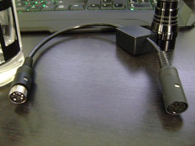

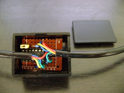

I made a keyboard adaptor up, it works great.
You need a programmer for the chip though, here's the link http://www.vcfed.org/forum/showthread.php?264 … board-converter
I'll post a photo of mine a bit later when I get home, it's a simpler design that the one in the link.
"New" style IBM CGA, varies only from the "Old" style in its composite circuitry (and in some cases, having a second-source CRTC). The "final" version of 8088MPH has settings so it looks correct on the new style card.
It's an MFM HDD controller, and it looks to have an option ROM, so will work in PC/XT machines.
It's a serial card, actually. Note the label "Async Card", and the presence of the 8250 UART chip.

Here's photo's of the AT to XT keyboard adaptor I made up.

Amd was making Intel processors under licence, because ibm only wanted to use the x86 processor when there was a second source they could use.
Yup, the AMD CPUs were exactly the same, transistor-for-transistor (as were the other second-source CPUs from eg Siemens and Harris).
In fact, it's rather strange that they put their own brand on it. That would be like taking a modern videocard, removing the heatsink, and finding "GloFo" or "TSMC" written on the chip, instead of AMD or NVidia.
But that is what happened.
The CPUs are completely interchangeable, so using an AMD 8088 with an Intel 8087 works just fine. As mentioned, I don't think there was much of a second-source for 8087 FPUs in the early days, so they would generally be Intel-branded (probably because of low demands).
This page lists AMD and Cyrix: http://www.cpu-world.com/CPUs/8087/
But they don't even have pictures of them, and the Cyrix one is said to only be produced in 1988. So they would be extremely rare.
This page says something about how few 8087s AMD would have made: http://www.cpu-world.com/CPUs/8087/MANUF-AMD.html
Generally other brands of FPUs were not second-source or exact clones, but had their own architecture that delivered better performance, such as the IIT or Cyrix FasMath chips.

You got there one first revision IBM 5160 motherboard, no more no less!
Indeed, both the motherboard and the CGA card are original IBM. IBM didn't label the PCBs for some reason.
I suppose one reason why could be that it is IBM: what else could it be? This is the original PC/XT, there were no clones yet. IBM could not have anticipated that third-parties would create drop-in replacement PCBs. A badge on the case would be enough to tell that it's an IBM.
Another reason could be that IBM was not used to building consumer hardware. They built mainframes, and who other than trained IBM technicians would ever even open the case and see the PCB? So why would there need to be a brand on it?
So I don't know exactly why, but yes... IBM PCBs from that era were unmarked, other than the ROM chips they made (as you can clearly tell, there's no custom chips on there anyway, it's all off-the-shelf stuff from Intel... the 82xx series. Apparently yours is sourced pretty much entirely from AMD).
So it may look like a random clone, but it is in fact the original 😀

I guess the GPIB card uses the NEC D7210 C which was used commonly as controller chip.
GPIB is widely used and still supported today: http://sine.ni.com/nips/cds/view/p/lang/en/nid/14341
Youtube Channel
Reply 16 of 31, by BloodyCactus
nice stuff. GPIB cards are still usefull, but not so much on ISA unless you had some super oldschool lab equipment to control. the nec control chip on it is probably worth a couple of bucks if you can desolder it cleanly.

GPIB is mainly used for industrial/lab type equipment. Eg, connecting an oscilloscope or counter to a PC. I've used GPIB at work with some Agilent (formerly HP) equipment not too long ago.
So the fact that this card came with the batch is an indication that the PC has been used in some kind of professional capacity, perhaps for developing/testing electronic circuits.
Reply 18 of 31, by BloodyCactus
I have a PCI GPIB card but Ive moved most of my stuff to LXI (GPIB over ethernet).
The ram card has 4164 type ram chips (64x1). Each 9 chip column is 64kb, so you have a 384kb expansion card (which on a stock XT which had 256kb, that gives you your 640kb!)

Q. One XT motherboard with an AMD processor and an Intel coprocessor (why?). Can someone identify this board? It looks like a clone board since I don't see IBM anywhere on it, but some of the chips are labeled IBM, so I don't know. It also appears to have all 256K of RAM 😀
A. That is an IBM PC/XT Model 5160 64/256KB Motherboard. The 8087 is a math coprocessor usually used to speed up CAD programs and Lotus 1-2-3.
Q. One CGA graphics card with the Motorola chip. Is this an original IBM card? I can't tell.
A. This is a late IBM Color/Graphics Adapter.

Q. What is this, a combination parallel/RAM card? And if that's RAM on it, how much is it?
A. That is an AST SixPakPlus card, it provides 384KB of RAM, one Serial and one Parallel port and a Real Time Clock. It can be upgraded to provide a game port.

Q. And this appears to be a parallel port card; correct me if I'm wrong.
A. That is the IBM Asynchronous Communications Adapter, a serial port card.
