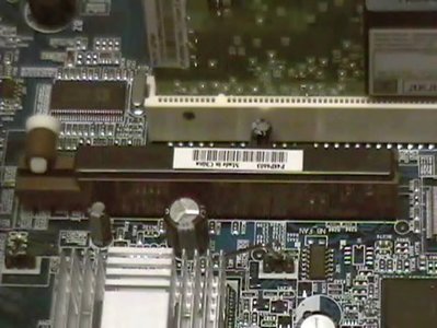

What a dead end. It will be a great board to test PCI cards in 😀. Might have to put up with a crappier MSI board 😉
The boards I was thinking of were some damn fine Netvista 8313-61Gs. It's a large batch I'll take a look at the other ones but I guess they have the same limitation.
But IBM messed them up pretty badly.
1. COM and front USB headers have some extra pins. Yeey.
2. The AGP is 1.5V only. That's a chipset limitation I could live with. But take a look at this picture (attached).
Quote from: https://support.lenovo.com/ro/en/documents/migr-53714
"Q: Looking at the system board, you will find an Accelerated Graphics Port slot. Inserted within the slot is a port block adapter, which will not allow for any AGP video adapter to be installed into the slot without being removed. When this blocking adapter is removed, and any AGP video adapter installed, the adapter will not function and the BIOS may not see the adapter.
A: The system is working as designed. This is a limitation of the system board as these are listed as Economy or Value systems with the functionality of the Intel 845GL chipset."

    Netvista AGP port blocker
Reply 52 of 68, by PARUS
Well it is not revelation. GL and GV versions have only internal AGP bus with integrated Intel video adapter. "AGP" slot is really only for Intel DVI out boards.
I thought that everyone knows it.
The majority of GV/GV mobos didn't even have AGP/PCI-E slot at all
Here a list of all Intel chipsets without graphic interfaces:
i810: first chipset without AGP support for low end and business
i810E/i810E2: updated version of i810 with FSB 133, PC133 support and the ICH2 southbridge. B-Step supports Tualatin
i815G: basically an i815 wihtout AGP slot
i815EG: basically an i815E without AGP slot, B-Step supports Tualatin
i845GL: was the sucessor to the i810 series and i815G/EG, basically an i845G without FSB533 and AGP support.
i845GV: replaces i845GL, basically an i845GE without AGP support.
i865GV: replaces both i845GV and i845GL, basically an i865G without AGP support.
i915GV: replaces i865GV, basically an i915G without PCI-E x16 support, some board manufactuers managed to implement x16 slots, but only x4 electrically.
i915GL: practically a 915PL with the GMA900 from i915G and missing PCI-E x16 support again.
i910GL: probably the most limited one, basically an i915GL without FSB 800 and DDR400 support as well, resulting in a FSB 533 and DDR 333 chipset, only supported Celeron D and FSB 533 Prescotts.
i945GZ: bassically an i945PL with the GMA950 and missing PCI-E x16 support, like i945PL it loses FSB 1066 and DDR2 667 support as well, some board manufactuers managed to implement x16 slots, but only x4 electrically.
Q963: basically a Q965 without PCI-E x16 support, also loses ADD2 card support. Is the last Intel chipset to come without video interface support.
