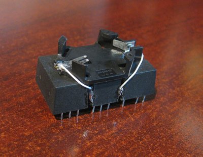

I've encountered endless stability problems with the HOT 433, and I have tested about 6 of these boards over the years. Personally, I would avoid it. There are others who report stability problems with it on this forum as well.
If you can find a Biostar MB-8433UUD which is revision 3.0 or 3.1, the Dallas RTC module should already be socketed, allowing you to perform the coin-cell mod with ease.
