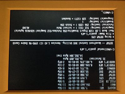

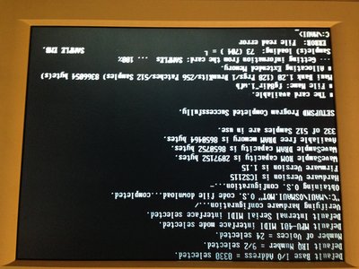

Just a quick feedback from testing:
The Fanta 8MB bank failed with this error:
1.51 MiB
1222 views
ERROR - Fanta Bank 8MB
The GUS 6MB bank loads fine:
1.51 MiB
1222 views
LOADING COMPLETE - GUS Bank 6MB
The bank is fully usable in games and Midi players, but the quality of some samples is really bad (drumkit), the volume alignment of the samples is also bad. But this is of course not a fault of the conversion. Although I didn't check it with the "original" .SF2 bank I suspect it sounding the same. Side observation: The Strings sample has quite a bit of reverb - must be prerecorded as I tested the soundbank with the MAUI. Although the conversion works fine I wouldn't recommend it over the default bank in the ROM of the MAUI.
www.AmoRetro.de Visit my huge hardware gallery with many historic items from 16MHz 286 to 1000MHz Slot A. Includes more than 80 soundcards and a growing Wavetable Recording section with more than 300 recordings.
Reply 56 of 104, by bristlehog
I weren't attentive enough and screwed that FantaGM 8 bank by carelessly replacing every 0x00000074 with 0x0000008A. There were instances of 0x00000074 not corresponding to sample size, just by coincidence parts of some samples' bodies. Example:
But it's okay - just my stupid mistake. What's more bothering is this:
We see that sample #72 somewhy has its size written as 0x74, but clearly it's much bigger as it contains embedded sample data. That's how the bank got corrupted: I replaced that 0x74 by 0x8A, and the next sample #73 was read, consequently, from wrong offset, thus getting totally screwed as we can see at Fabian's screenshot: the sample number is all wrong (704 instead of 72), the sample name is some piece of pseudo-graphics etc.
It seems that I don't quite understand the meaning of that 0x00000074 piece of data. I have to research and think where my mistake is.
Meanwhile, here's the third version of Fanta GM 8:
http://geryon.ru/fg8dirt3.zip
It has been fixed the way that only sample #424 and further samples have their 0x74 value changed to 0x8A.
