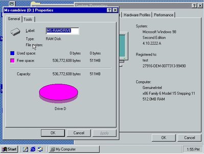

Reply 5 of 14, by Roman78
Your tip is working, at least I testet it on a virtual machine. Added up to 1 gig of ram and set the max on 128, and i got 128.
Now when I add a ram drive into autoexec.bat, now i have 8 meg, it will leave 120 over. It's just testing now. Didn't worked in config.sys
But now every time I boot i got a message if I want to run that. Is there a way to just autorun the autoexec.bat?
You noticed, long time ago I used 98... oohhhh 😊
here a picture, but this tells nothing about stability.
    83.96 KiB
    1426 views

I think whit 512Mb of ram, you won't need a Swap file, so you could set it to Zero or maybe 16mb.
What I did now is redirect the Temp files to the ram drive. This, first is faster than the harddisk (duh) and less fragmenting it. And everything is cleared up after a reboot.
this I have in my autoexec.bat
xmsdsk [harddisksize in kb] [Driveletter] /y /t
md r:\temp
set tmp=r:\temp
set temp=r:\temp
/y don't ask questions while starting
/t use the most up end memory block available.
Till now, after one day, works fine.
