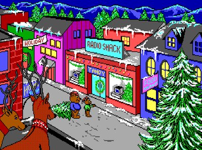

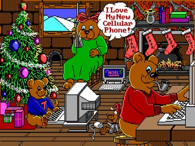

Reply 32 of 112, by liqmat
This seems appropriate for a 16 color Christmas. One of my favorite old Christmas demos (I'm sure some of you have this already) and it only works on a Tandy, so set your machine type to Tandy and run the bat file. It also catches us all up to their latest 1980s models! haha Hope you all have a great Christmas and New Year!
567.12 KiB
2762 views
689.74 KiB
2762 views
hxtxxmas.zip
376.73 KiB
132 downloads
