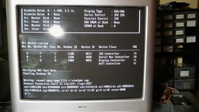

Tried 7z-zip 16.02 in DOS with CWSDMPI and it worked on my thinkpad, but i tried in another board (QDI Advance 9) and it got errors for some reason, 4.53a runs without problems on that system

I've only ever tried with DOS 6.22. I've tried with it on hdd and boot floppy. So far it has worked on every machine: 486, Pentium, PII, K6-2. I wonder if there is something about Win7's DOS that causes this issue? Do you have access to an older DOS?

I used a Windows 98 based boot floppy on that test, but somehow, is not working in all machines ¿do you have an floppy image of what DOS floppy are you using? I don't have any DOS 6.22 machine here, Windows 95B is the oldest i got

I tried the 6.22 Bootdisk, still begs for cwsdmpi, even with EMM386 enabled
Update. tried another version of cwsdpmi and worked now

I don't enable EMS. Just Extended. If you use Phil's MS-DOS boot menu, it's option 5 that I use (Extend Memory with Mouse).
Try redownloading the file. Here's a link to my post with the 16.02 version:

You should not have to use CWSDPMI at all. I do not and it works fine without it.
