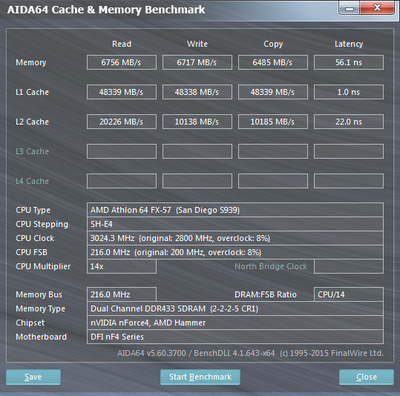

I own FX-57 and I OC'ed it to 3GHz+ but only proof is cache/memory test :
193.81 KiB
689 views
^Scratch that, I found CPU-z Validation : LINK 😁
