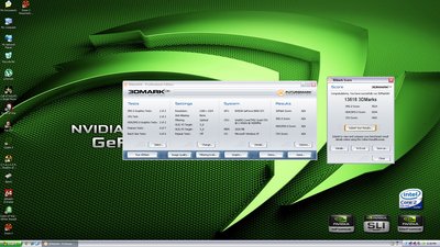

I freaking love the 2900XT. Here's mine:
I had a pair of these back in the day - traded my 8800GTX and a little $$ for them - people hated them that much. They doubled as a room heater when gaming, but I remember playing stalker and crysis in these and they were SMOOTH. I also loved how these would gain performance with every driver update. Still looking for a pair for the one I have, but they're relatively rare.

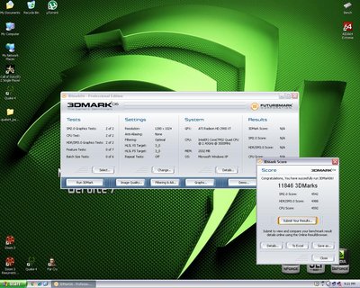

And here's the 8800GTS 640:
338.37 KiB
673 views

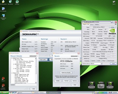

Now on the SLi topic - here's how the pair of 7950GT cards I posted above score on a Q6600 / Nforce 780i:
262.7 KiB
