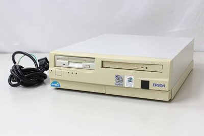

As mentioned in the recent purchases thread, I bought a small Japanese PC on Yahoo Auctions Japan through a middleman service about two months back, which I received just yesterday. This is the result of a search for a system that would let me assess whether using a Japanese PC with a Japanese version of Windows or MS-DOS is feasible with next-to-no knowledge of the Japanese language, so maybe I can buy myself a PC-98 system later on. However, I also wanted a system that I could use with a US version of Windows if necessary, that was small enough because I haven't got much room in my house (and I also wanted to avoid a HUGE shipping bill), had a 100V/220V switch on the power supply, and that was a certain age.
Auction picture:
14.77 KiB
2157 views
This is an Epson Endeavor AT-550L, more precisely a computer sold by Seiko Epson through their early online mail order division Epson Direct back in 1998 (first announced in January 1998).

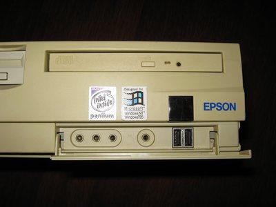

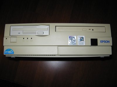

First, some better pictures of the outside.
Front, showing floppy disk drive and slimline CD drive:
423.39 KiB
2157 views

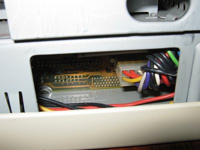

Several connectors are hidden behind a little panel (unfortunately one of the hinges is a bit busted):
441.42 KiB
2157 views
Audio output and microphone connectors and two USB ports. The black square above it is for infrared. Also an Intel Inside Pentium sticker and a Windows 95/NT sticker. The system should have a Japanese Windows 98 on the HDD, though.

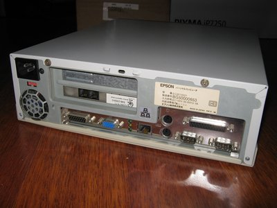

Rear end:
583.47 KiB
2157 views
From left to right and top to bottom, switchable NLX power supply, Dell slot cover that probably means the system originally came with a optional VGA card that was removed and stuffed into a Dell, 56k PCI fax-modem (probably not a Winmodem) in the lower slot, game/MIDI port, VGA port, 10/100 Mbit 10Base-T network port + LEDs, PS/2 mouse and keyboard connectors, parallel and COM ports.

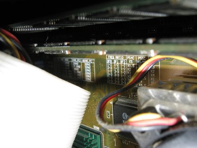

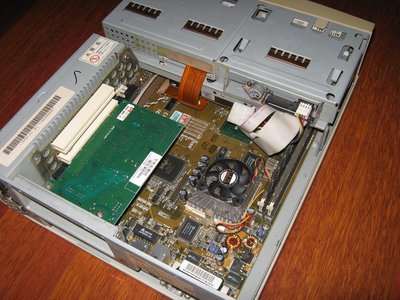

The first thing I did after receiving the computer was to pop off the cover. This took slightly more time than anticipated, as the screws on the rear are more for show, and the cover is held very tightly to the rest of the system using a lot of clamps. Should anyone else ever get one of these and have to remove the cover, after removing the screws, you need to carefully slide the cover off the rest of the case using quite a bit of force by first sliding it about 5 cm backwards and then pulling it straight up. The bottom of the case is protected by a plastic tray that can't easily be removed.
Insides overview:
855.65 KiB
2152 views
It's a fairly small case (30 by 40 cm or so) that's tightly packed with components. Caps look good by the way, no worries there. The motherboard and riser are Asus OEM parts, more specifically a SP98-N motherboard in the NLX form factor, which according to the manual is like a high end board stuffed into a small form factor case. It has 256 Kb of secondary cache and TAG RAM soldered right to the board, tons of BIOS options, and these options for processor and bus settings:
865.6 KiB
2152 views
427.1 KiB
2152 views
(sorry about the bad second picture, but I haven't figured out yet how to lift up the section of the case holding the drives that cover part of the motherboard)
It's too bad that the case is so small, but it looks like this thing would be very good for overclocking...

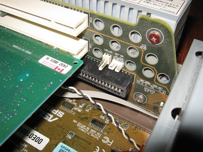

The power supply is a special NLX power supply, which appears to be a small form factor ATX power supply. It connects to the riser board:
451.78 KiB
2152 views

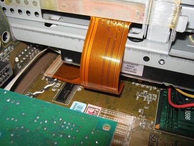

The slimline CD-ROM drive attaches to the motherboard using a special cable that attaches to a special CD-ROM connector that is separate from the IDE connector:
757.27 KiB
2152 views

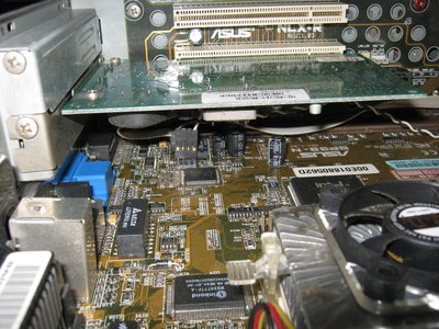

Reply 2 of 28, by yawetaG

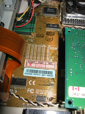

A look at the riser board, with fax modem blocking the view a bit:
801.88 KiB
2152 views
784.92 KiB
2152 views

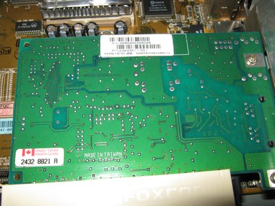

By the looks of it, the fax-modem likely is a fully featured modem, not a Winmodem that only consists of a single chip. The riser board is specific to this motherboard and handles more than just the expansion slots: the FDD and IDE connectors are attached to it. There is an alternate riser board that supports two IDE channels; this one only supports a single channel (two devices).

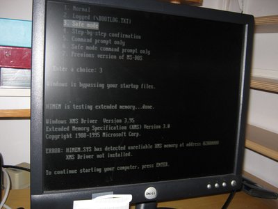

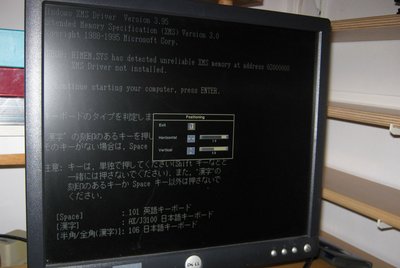

However, Windows 98 (Japanese) craps out with two errors:
- HIMEM.SYS complains about unreliable XMS memory at address 02000000 (bad memory module?). The weird thing is that it does this after testing the extended memory successfully. No errors are displayed during the POST memory test.
- Apparently it expects a Japanese 106 key keyboard.
However, I suspect it might just be that the Windows 98 install is screwed up, as it appears to be the original 1998 installation. I managed to boot up to a Windows 98 command prompt by processing the start-up files manually (F8 boot option) and disabling HIMEM and the Japanese keyboard driver. The HIMEM error doesn't actually stop Windows 98 from booting, it hangs on the keyboard error.
Tried to boot from CD-ROM, but as stated in the auction the CD drive doesn't read. The disks spin up properly, followed by a lot of seeking noises and a read failure message - probably a dead laser. The CD-ROM drive is weird. It is hooked up to its own connector, and can't be disabled at all through the BIOS. During boot it is listed as depending from the second IDE channel
I managed to successfully boot from a Windows 98 boot floppy, which didn't throw up any memory related errors. Guess I'll have to try again with a floppy with Memtest86 on it. I also ran Scandisk on half* of the harddisk, and it was completely error-free (not bad for a 2-decade old 3Gb hard disk).
*US Scandisk doesn't like Japanese characters and craps out on files with those characters in the name, saying the files are corrupt because they have corrupt characters in the filename. WARNING: It also deletes the files instead of making a backup copy if you tell it to fix them! 😠

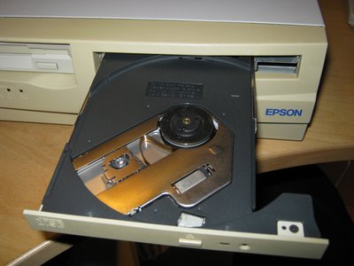

Reply 6 of 28, by yawetaG
Dead CD-drive (tray opens, spins up, doesn't read):

Windows HIMEM error message, anything to worry about?:
161.06 KiB
1974 views

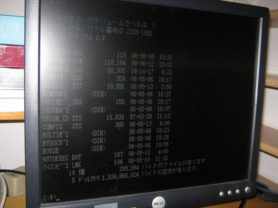

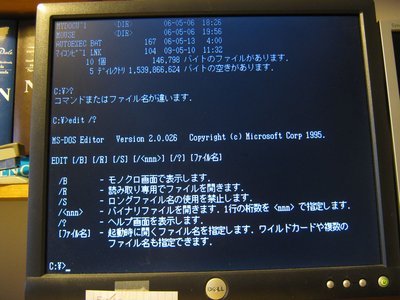

Booted into Japanese Windows 98 DOS:
180.01 KiB
1974 views
Gah, just googled it and it may mean the cache controller is bad 😢 Will first test the RAM.

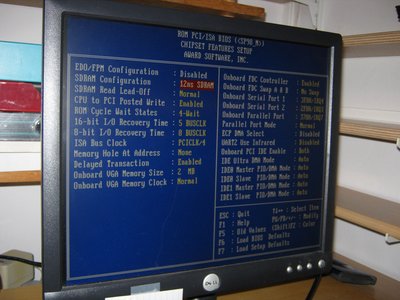

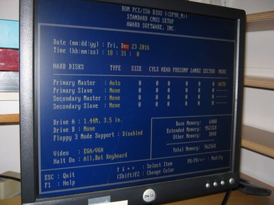

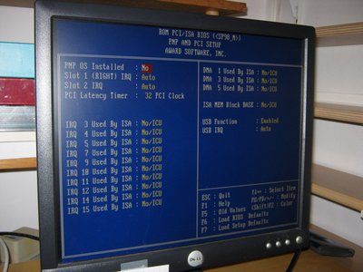

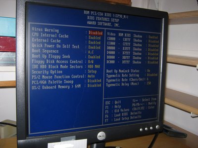

BIOS screens (forgot to take a picture of the main screen).
BIOS features setup:
224.83 KiB
1972 views
Chipset features setup:
219.4 KiB
1972 views
Standard CMOS setup:
211.69 KiB
1972 views

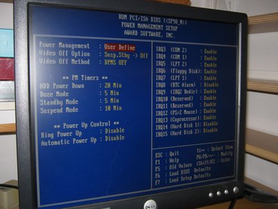

Power management setup:
221.04 KiB
1972 views
PnP and PCI setup:
213.83 KiB
1972 views

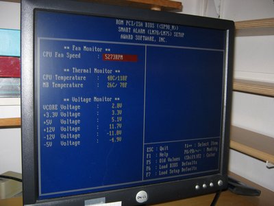

The board has on-board diagnostics.
Smart Alarm (LM78/LM75) setup:
192.34 KiB
1972 views
The CPU temperature went up to 55 degrees Celsius during operation (no heavy loads). Should I check whether the CPU fan operates properly?
The voltages look pretty good...

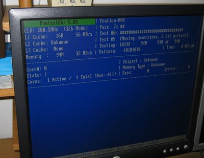

Reply 11 of 28, by yawetaG
Started running Memtest86, which sees 94 Mb of RAM (this is correct; 2 Mb is used by the onboard video card), and reports a Pentium MMX with a clock speed of 200.5 MHz and 16K of L1 cache (correct), but fails to recognize the chipset, memory type and L2 cache (probably due to being somewhat unusual hardware that it doesn't know...). Until now no errors, but it's only been running for 40 minutes...
Edit 1: pass 1 successful, but pass 2 didn't start, so I hit the escape key and the system hung itself because those bits of the system not in use had gone in power saving mode and they didn't wake properly 😵 One hard reboot later and memtest86 pass 2 is underway with all sleep/suspend/coma options disabled in the BIOS.
Edit 2: Pass 2 completed successfully, with power saving options disabled it continues with the next pass properly.
Hmmm...found this (last post), which explains the why Win98 DOS only sees 64 Mb...however it makes me wonder whether Microsoft coded the Japanese version of Windows 98 in such a way it can't boot properly with a non-Japanese keyboard... That would be so beyond stupid...on the other hand, Microsoft. 😐

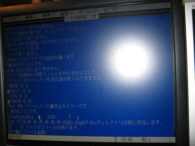

Here's a look at Japanese Windows 98 Command.com, mixing English and Japanese in the same file:
130.54 KiB
1790 views

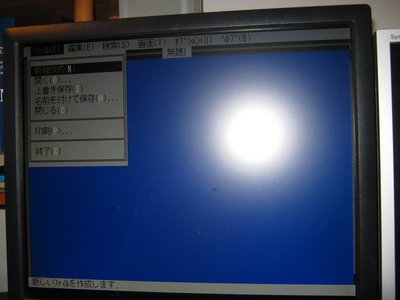

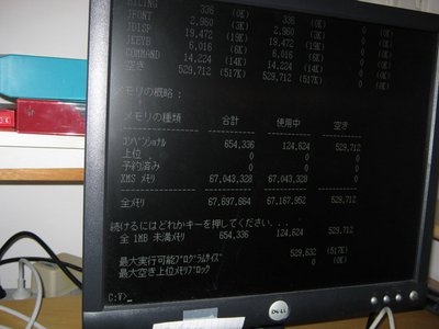

Reply 14 of 28, by yawetaG
4) Then I just tried to boot straight into regular MS-DOS, and it worked.
174.96 KiB
1789 views
Check out that memory! Himem.sys and EMM386 both properly loaded. 😎 At this point I started to wonder what could prevent Windows from working, while DOS worked fine...corrupted files? Improperly shut down Windows 98?
So why not explore a little further?

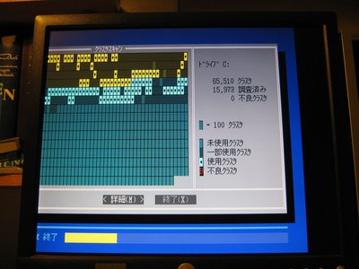

5)
192.63 KiB
1789 views
JP Scandisk up and running 😁. It found some corrupted file, which I made it fix. I've used these programs so often in the past that I more or less know what each button does, meaning a mere different language wasn't too much of a problem.

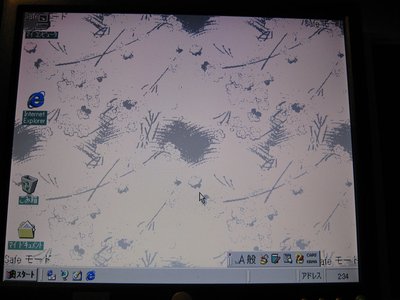

Oh wow, and although it starts very slowly, regular Windows 98 also works, and this computer doesn't have a beeping speaker, but build-in real sound!
Oh gods, shutdown is even slower...can't figure out whether it hangs or whether I need to press the power button to really switch it off... 😵 This NLX power supply is weird. It's supposedly ATX, but behaves like a AT power supply.

Windows not shutting down is a common problem with win9x. It can be driver related (i forgot the exact reasons) but there are several fixes when you search Google.
It can also be a simple bios setting about power management.
Reply 19 of 28, by yawetaG
yawetaG wrote:
Check out power management
Checked out, I can't read anything and will need to check the possible settings in my Windows 98SE install on another machine.

defrag hard disk
Started off with the D drive, then later did the C drive. When defragging the C drive was almost complete, the video output got screwed up, then the completion chime sounded, but I had to reboot the machine because I couldn't see anything anymore.
Then, after running Scandisk in DOS, I typed "win" to start Windows 98 from MS-DOS, after which Windows performed a Scandisk check by itself. At this point it also must have changed some settings, because the next time I tried to shut down the "suspend" option had disappeared from the shutdown dialog box. Restarted the system from the dialog box instead, continued checking some stuff and enjoyed the better speed obtained through defragging a drive that seemingly was never defragged before. Then I shut down the system, and it actually shut down properly 😳 . I...I don't know what happened, actually 😕 . It looks like the seller attempted to reset Windows 98 to factory settings (and I suspect he simply pulled the power plug instead of shutting it down properly), and then when I started it the first few times it did not detect the configuration properly, needing a certain amount of reboots and applications of system utilities for things to work out. Weeeeeiiiird. I certainly did not expect to be able to actually fix these kind of issues without reinstalling Windows, but it did work out. 😀

Other: Fix or replace CD-ROM drive.
