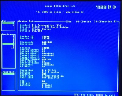

Anyone care to clarify this?
In this post, stamasd says to modify offsets af4b and af83, but in this post, Kamerat says to modify offsets aec0 and aec1.
j^aws wrote:
BTW, these images show version 3.11 of the Yamaha setup utility. IIRC, the latest version is 3.16; try that version as well. Also, keep in mind that not all chipsets have all features available via SB-Link.
Thanks.
I managed to get 3.16 from Yamaha afterall. Their page is down, but the files are still on their server:
http://download.yamaha.com/api/asset/file/?la … &asset_id=46447
Also, I'm not clear on why only the Device ID has to be changed but not the vendor ID...

Reply 25 of 29, by mockingbird
gdjacobs wrote:
Modding a device ID from the same vendor, perhaps?
Ah, ok thanks. Makes sense... Indeed, there is "06 11" (vendor 1106 - VIA) in aec5 and aec6.
The problem is that "B9 10" (10B9 - ALI) shows up in many places:

Reply 27 of 29, by Kamerat
mockingbird wrote:
Anyone care to clarify this? […]
Thanks.
The attachment IMG_1927.JPG is no longer available
Looks like your PCI ID is already in there, device ID at offset AE4A-AE4B and vendor ID at offset AE4F-AE50.
You can always try this modified exe, not sure if it will work as I exchange one of the Intel IDs with yours and made the old one read as 3412:3412. 😜

Reply 28 of 29, by mockingbird
Thanks.
Could not get it to work... There are three options when choosing the IRQ type, INT, Soft IRQ, or ISA. ISA is greyed out. S-IRQ allows you to select the IRQ but the program says it can't find the IRQ when you try to save.
Got an old MEW-AM (It's an Asus board for an HP Vectra IIRQ) with an unpopulated SB-Link header. Gonna try it on there just to see how it works, if it does even work. this is an Intel 810 Chipset.
EDIT: Darn, I ripped all the caps out of this thing a while ago. I have to put them back in before I try it on this thing.
