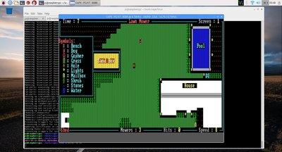

I've been working hard on version 0.4 (and I will have a release soon). However here it is running (or trying to) on my Raspberry Pi 2 version 1.1. It seems I have some optimization work to do.
The ARM Cortex A7 at 900Mhz can only run the cycle based emulation of an IBM PC XT at mostly about 1Mhz 🙁
On a Raspberry Pi 3 I expect to run about half the speed of an 8088.
Still it was fun to see it run! 😀

    CAPE 0.4 running on Raspberry Pi 2 1.1

Still good enough to include in their repository with every other unusually slow emulator. DOSbox can't even refresh Doom's STARTUP text-mode screen at a tolerable framerate on that thing.
