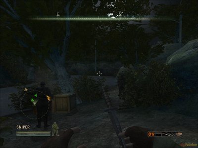

Commandos: Strike Force
Looks correct. Resolution forcing and all (though unnecessary).

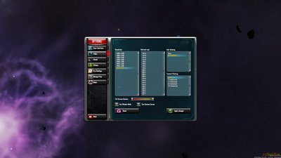

That's great news. I think Call of Cthulhu: Dark Corners of the Earth and Sins of a Solar Empire are worth looking into. Other than the fact that they don't work (CoC: DotE says failed to create device, SoaSE has rendering issues), they both behave weird with resolution enumeration:
44.05 KiB
6967 views
426.38 KiB
6967 views
Those are two custom resolutions I added. If I remove both of them, the games will enumerate NO resolutions. Trying to limit resolutions via config file seems to have no effect. Natively both games enumerate all resolutions on my system. Obviously games commonly don't support either of those resolutions so other games suffering from the same issue might just crash.

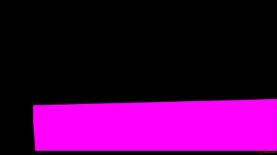

Company of Heroes (demo)
Starts now, but invisible mouse cursor, invisible movie subtitles and when it comes to 3D rendering...:

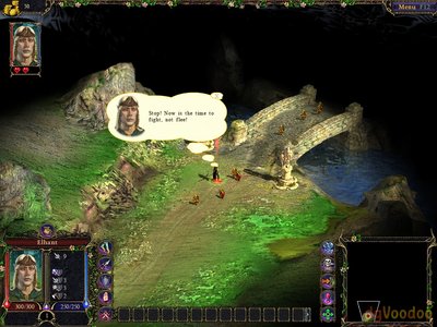

Heroes of Annihilated Empires
Low shader quality:

High shader quality:
323.89 KiB
6967 views
So only low shader quality usable. Would still very much be preferable to run it with dgVoodoo if resolution forcing worked, but it doesn't (the game sets its resolution regardless of dgVoodoo setting).

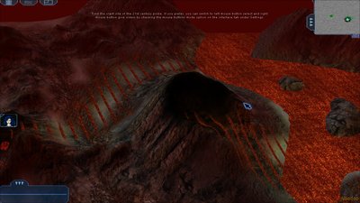

Might need to start with -safemode, works now but with some issues, see the lava and lack of fog in this picture:
827.92 KiB
6966 views

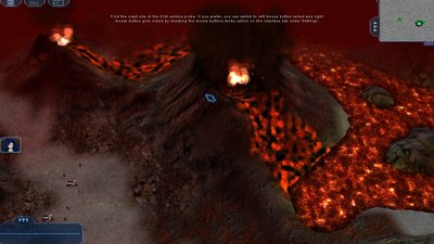

Native comparison:
199.63 KiB
6965 views

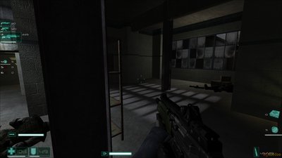

F.E.A.R
Complains that it doesn't have enough VRAM (regardless of what it's set to in dgVoodooCpl):
408.21 KiB
6965 views
Renders fine though:
374.18 KiB
6965 views
But performance is terrible regardless of settings with awful framerate drops almost down to single digits. Wonder if it could be related to it thinking it doesn't have enough VRAM? Would be really nice if it was possible to get this working in dgVoodoo, I'm currently playing it at 720p to get the UI readable.

Reply 635 of 1111, by Dege
Hmm... I don't understand why performance of FEAR is so bad for you. I have it running at 100-200 fps at maximum settings in 2560x1440. (yes, it complains for low video memory, I Will look into it later)
Also, Lego Star Wars run just fine last time I tested it (can't have a look at it atm).
One general thing: sm2 is only supported through the internal virtual video card and the GF 5700 ultra.
Reply 636 of 1111, by ZellSF
Do you get the video memory warning when going to settings? My average framerate is pretty high too, what's your minimum framerate?

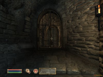

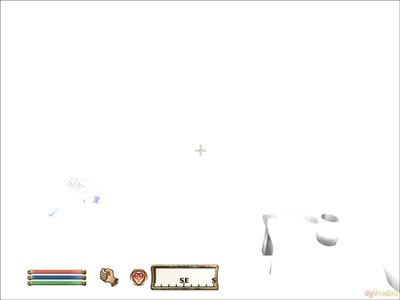

Elder Scrolls IV: Oblivion
Even with shader model 2.0 support this still renders very wrong:
47.5 KiB
6896 views

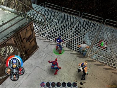

Marvel: Ultimate Alliance
I think this is shader model 2.0 which is why I haven't mentioned it before. It works now, resolution forcing creates mouse issues (wrong coordinates).

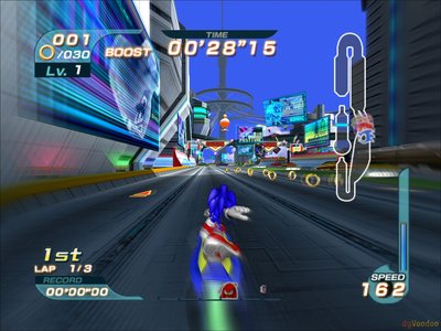

Sonic Riders
Works now, resolution forcing and all.
460.91 KiB
6896 views

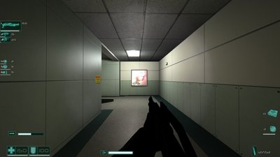

Reply 637 of 1111, by ZellSF
F.E.A.R has issues with flashlight (and the picture on the wall here):
310.13 KiB
6890 views
How it's supposed to look:
100.45 KiB
6890 views
Reply 638 of 1111, by Dege
ZellSF wrote:
Yes, I get the warning. But in spite of that, I can freely set the resolution and any other option. AFAIR, I got ~85fps as a minimum. But, I played through the first 3 levels at 200-300 fps' with FSAA and soft shadows disabled.
Also, Oblivion should work perfectly now. Your screenshot seems like there is no SM2 support for some reason.
Reply 639 of 1111, by ZellSF
Dege wrote:
ZellSF wrote:
Right you are:
303.85 KiB
6881 views
But also maybe wrong?
The Oblivion white screenshot was from GF 5700 Ultra. Setting it virtual 3D accelerated card fixed it.
Edit: Heroes of Annihilated Empires works with shader quality set to high too then:
257.94 KiB
6874 views

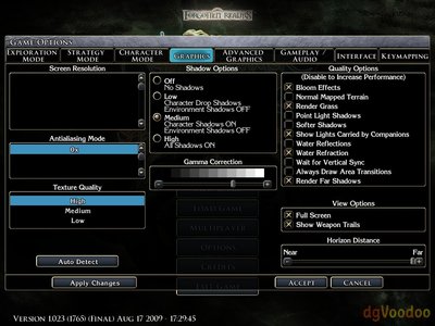

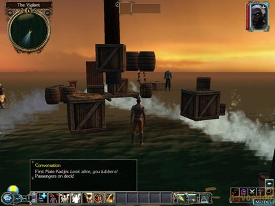

Neverwinter Nights 2 runs, but I'm sure my system supports more resolutions than this:
171.51 KiB
6870 views
I also recall my ship being a bit nicer than this:
139.97 KiB
6870 views
Earth 2160 with shader model 2.0, still obviously wrong:
740.61 KiB
