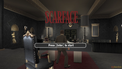

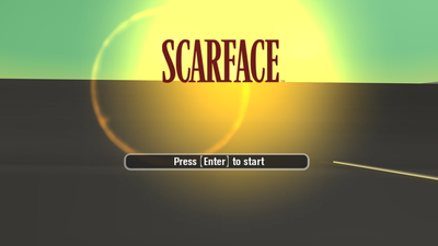

Just tested the latest WIP build on Scarface: The World is Yours, looks like the "polygon hell" bug is fixed! 😁
Before:
Scarface 2018.11.21 - 00.47.53.03.mp4_snapshot_00.04_[2018.11.21_00.58.10].png
935.03 KiB
3152 views
After:
Scarface 2018.11.21 - 00.31.11.02.mp4_snapshot_00.20_[2018.11.21_00.58.46].png
1.97 MiB
3152 views

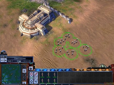

Star Wars: Empire at War
Seems to run nicely though I can't comment on performance with this computer. Changing resolution lead to crashes so I didn't want to experiment with resolution forcing. I'm guessing it would work nicely though as you can disable hardware mouse in this game. Pointless though.
697.97 KiB
3008 views

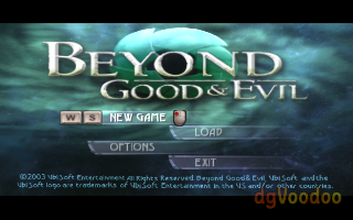

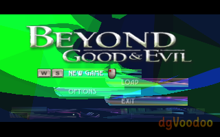

Beyond Good & Evil (demo)
Settings application doesn't seem to work, so here's the menu in high-res 320x200 (I'm pretty shocked the game supports a so low resolution):
37.99 KiB
2988 views
Yeah... It's not supposed to look like that. Using the demo's /singlestream compatiblity parameter:
83.78 KiB
2988 views
New game will just display one frame then crash. I got the game running at 640x480 and it still crashed so it's not that, plus it runs natively.

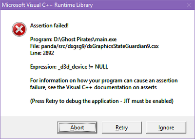

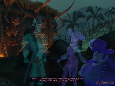

Ghost Pirates of Vooju Island
Windowed mode works:
114.45 KiB
2973 views
Fullscreen does not:
12.6 KiB
2973 views
D3D9, but requires ddraw.dll.

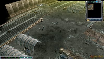

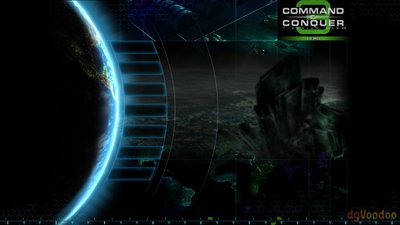

Command & Conquer 3: Tiberium Wars (demo)
Now with less reading:
118.86 KiB
2912 views
Yeah none of the text renders correctly. 3D rendering looks sort of OK, but there are some issues I need to get comparison screenshots later:
311.05 KiB
2912 views
Will crash at start if antialiasing is set to on in in-game settings.

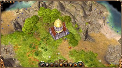

The Settlers II: 10th Anniversary (demo)
Shader quality high:
417.04 KiB
2912 views
Obviously wrong, but shader quality low looks pretty good:
405.71 KiB
2912 views
Unfortunately, resolution forcing creates too many mouse issues. With or without hardware mouse enabled.
