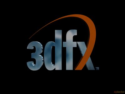

WIP versions
Reply 700 of 1111, by ZellSF
More adventures in doing pointless stuff, nGlide works:
75.33 KiB
1791 views
I had an issue playing Outlaws under nGlide (ingame menus weren't rendering correctly), but the game itself rendered properly.

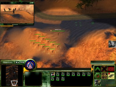

Act of War - Direct Action
Seems to work (with resolution forcing). Problematic window handling forced window mode for me though.
584.84 KiB
1690 views

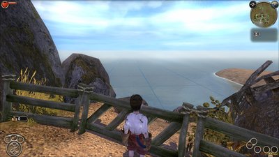

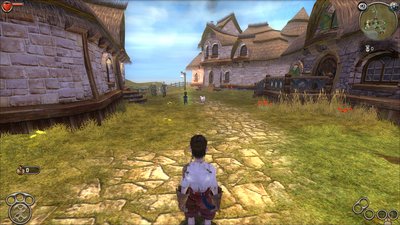

Fable - The Lost Chapters
Crashes in fullscreen, window can't get focus if "Disable Alt-Enter to toggle screen state" is on. Performance isn't ideal. Rendering otherwise seems OK. Resolution forcing works:
1.03 MiB
1693 views
If you can tolerate some issues:
665.41 KiB
1693 views

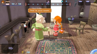

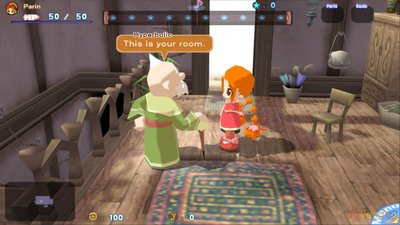

Gurumin
Seems to work. Resolution forcing too.
452.15 KiB
1693 views

luigi-master wrote:
Hey Zell, I appreciate you testing those games out, I appreciate it! However Gurumin looks like it has a soft picture (especially compared to Fable), as if it's being upscaled. Can you confirm that it's the case, perhaps disable anti-aliasing of all kinds?
That screenshot was from the game running at 1280x720 with dgVoodoo forcing resolution, if resolution forcing wasn't working it would look like this:
393.5 KiB
1596 views
That's 1280x720, upscaled by dgVoodoo2.
Low-resolution models and textures do not really benefit massively from high-resolution support, but rendering in a higher resolution is just often preferable to dealing with scaling problems.

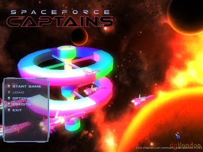

Spaceforce Captains (demo)
Will only load d3d9 from SysWOW64 unless exe is edited and then:
143.79 KiB
1551 views

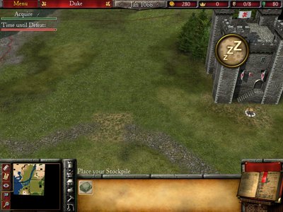

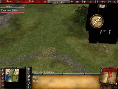

Stronghold 2 (demo)
dgVoodoo:(regardless of shader version set in game config):
661.17 KiB
1529 views
Native:
745.64 KiB
1529 views

Reply 715 of 1111, by Dege
How do you edit the exe? It only loads d3dx9_31.dll and d3dx9_32.dll. This game seems to be easily debuggable, so it'd be cool to run it through dgVoodoo.
Reply 716 of 1111, by ZellSF
Dege wrote:

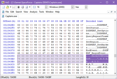

Well the way I do it (which probably isn't the right one) is open the exe in a hex editor and find this:
37.83 KiB
1438 views
Replace "d.3.d.9" with "v.3.d.9" and rename dgVoodoo d3d9.dll to v3d9.dll and put it in C:\Windows\SysWOW64

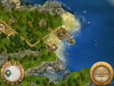

Anno 1701
3D renders OK, as seen here:
251.72 KiB
1382 views
However some 2D objects are obviously missing, here's native:
253.72 KiB
1382 views
Might have to launch the game without dgVoodoo to turn all graphic settings to minimum to get the game to run.

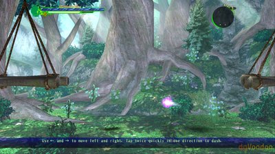

Fairy Bloom Freesia
Doesn't render characters:
775.51 KiB
1386 views

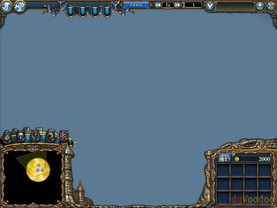

Doesn't render game world properly. Game specifically says shader model 2.0 is minimum version:
99.67 KiB
1386 views
