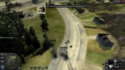

Reply 769 of 1111, by ZellSF
World in Conflict (demo)
Seems to work. Resolution forcing too, though the icon row in the middle bottom is the only thing that benefits from it (Everything else is properly scaled to resolution) and you get some minor text glitching.
Performance is a bit wonky, antialiasing creates some minor issues and you don't get any effects from the DX10 render. So dgVoodoo probably not the best way to play this game.
552.76 KiB
2365 views
There's also this every time you start the game:
--------------------------- Serious problems found when starting World in Conflict --------------------------- ERROR: No appropr […]
ERROR: No appropriate 3D graphics card detected. Unable to run World in Conflict.
It is highly recommended that you try to fix these problems before running the game.
Press OK to quit or press Cancel to try to start the game anyway.
OK Cancel

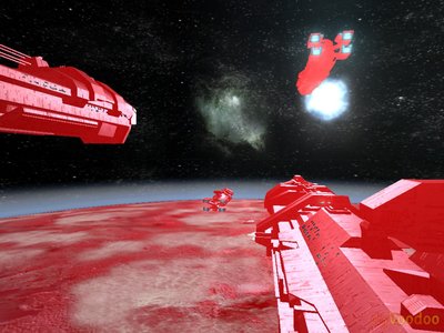

Reply 772 of 1111, by ZellSF
Starship Troopers
Shader detail low:
176.35 KiB
2214 views
Shader detail medium/high:
182.06 KiB
2214 views
Obviously something wrong here.
