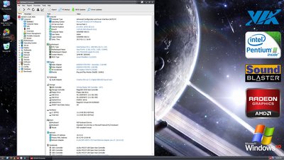

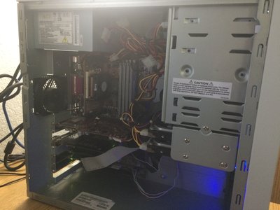

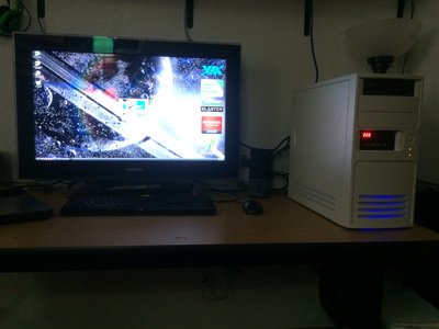

I did have this build in a blue case, but I didnt like the fact that the paint was pealing bad, so this case looks nicer, it has the storm troop look going on.
I just wanted to see what this board cold do, no overclock yet. Here are the specs so far.
Windows XP Pro SP3 black edition, I personally love this edition, virus free and I pick what I want
2x 120GB HDD, soon to be swapped out for 2x 120GB SD cards. Im thinking about putting lubuntu on the second drive.
Pentium III-s 1.4GHz with slotket adapter.
2GB of SDRAM with heatspreaders
128MB Radeon 9700 Pro I did a few benchmarks with different cards that I had to see what card would max this build out,
Floppy emulator
ALI USB 2.0 card with 2 rear ports and 4 front ports
Asus P3V4X motherboard
Things to upgrade to:
Im thinking maybe a 9800 Pro would be maxing the 4x slot out.
2x120GB SD cards for speed, less noise and less power consumption
All Benchmarks @ 1024x768 32:
with Radeon 9550xl 256MB: 3DMark2000 6469, 3DMark2001 5801, 3DMark2003 2103
with Radeon 9700 Pro 128MB: 3DMark2000 6683, 3DMark2001 7305, 3DMark2003 4407
With Radeon HD 3850 512MB: 3DMark2000 7202, 3DMark2001 8764, 3DMark2003 Would not run
With Geforce 6800 GT 256MB: 3DMark2000 7334, 3DMark2001 7455, 3DMark2003 6811
With all video cards unreal gold ran at an average of 52 frames @ 1280x1024 32
To high of a video card resulted in bad performance on some games.
    346.6 KiB
    1903 views
    x0zm_ did the logos on the wallpaper

I think it looks very nice!
And definitely loving blue lights here!
I actually really like your case. For some reason your system does look pimped, but it kinda even looks period-correct as well even though it's easy to see some of the parts are newer.
Definitely like how you maxed your rig, especially the RAM. It even reminds me of the rigs Artex has build and he sure has an eye for visual delight (even though some might see it as over the top 😜).
It's difficult to see, but your PSU seems like an FSP design of 300W.
What kind of slotket did you use? And how is XP BE now? I may have given it a go yeeaars ago but I didn't like all the extra stuff they put on it.
Only minor gripe I can see is the black optical drive 😜
Nicely done!

Yep its FSP 300watt Caps are still good, almost new. I am a little unsure about the power supply though I don't know to much about them.
yeah RAM is a little over the top, but it was $10 for all four sticks and XP is a little thirsty. It show's the capabilities of what this board could do for its time.
I love XP BE its fast and its pre tweaked and I usually uncheck a few things from its list in setup and I also tweak a lot of things after setup like turning of system restore, print spooler, indexing services etc everything I don't use. When sitting in idle my RAM usage is at 134MB.
For the cpu I order these: http://www.ebay.com/itm/Tualatin-P-IIIs-1-4GH … Q0AAOxyRhBSxjSY The p3v4x is a little picky on the slocket adapter, im using a super slocket III adapter. You could use a power leap, but i would not recommend it was this board cause the volts are a little high with a power leap causing the caps on the power leap to explode. When the modded p3-s is paired with a slotket adapter the correct volts are displayed in the bios.
