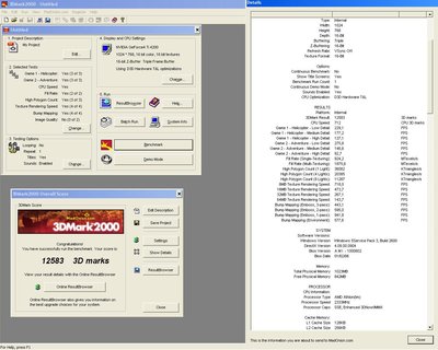

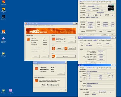

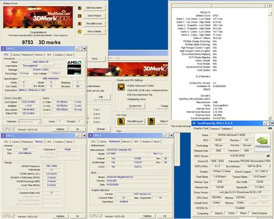

I did some testing with my Asus A7V880 VIA KT880 motherboard.

Asus A7V880, Thoroughbred B 2333 MHz (2900+), single channel memory: PCMark 2002
178.49 KiB

Asus A7V880, Thoroughbred B 2333 MHz (2900+), Geforce 4 Ti 4200 @ stock, single channel memory: 3dmark 2000
193.65 KiB

Asus A7V880, Thoroughbred B 2333 MHz (2900+), Geforce 4 Ti 4200 @ stock, single channel memory: 3dmark 2001
258.08 KiB

The conclusion is that the performnce with the KT880 chipset running single channel memory is the same as with the KT600 chipset. It's also only ~1 percent faster than the KT266A, KT333 and KT400 and that could be because I actually bothered to tighten up memory sub timings with the A7V880 motherboard.
As the performance with all VIA DDR chipsets for Socket A with the exception of the somewhat flaky original KT266 is more or less the same I can use this Asus A7V880 motherboard with full multiplier control to test all Socket A CPUs for the scaling tests. This will save alot of time as I only have to use one Spitfire Duron, one Thunderbird Athlon and so on.
