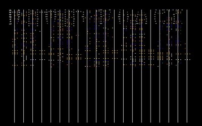

Edit: Now retrying with the following MS-DOS 5.0a CONFIG.SYS:
DEVICE=HIMEM.SYS
REM DEVICE=EMM386.EXE
DEVICEHIGH=C:\SB\DRV\CTSB2.SYS /UNIT=0 /BLASTER=A:220 I:5 D:1
DEVICEHIGH=C:\SB\DRV\CTMMSYS.SYS
DOS=HIGH,UMB
REM ** DEVICE=D:\SB\DRV\CTSB2.SYS /UNIT=0 /BLASTER=A:220 I:5 D:1
REM ** DEVICE=D:\SB\DRV\CTMMSYS.SYS
FILES=40
REM ** files= 30
DEVICE=D:\MSDOS\LTEMM.EXE /n
DEVICE=d:\uniide\vide-cdd.sys /D:MSCD001
Although the D:\ device drivers don't exist in the current configuration.
Edit: Now the application doesn't complain about memory and simply hangs with the following screen:
74.08 KiB
283 views
Megarace not refusing to start with loading high device drivers.
Edit: It seems to be hanging in the BIOS somewhere(segment F000)?
UniPCemu Git repository
