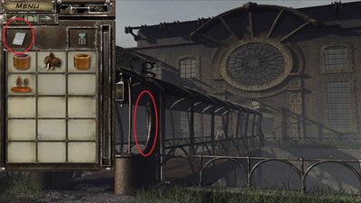

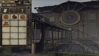

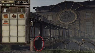

Is their anyway to get rid of the texture tiling artifacts on 2d backgrounds caused by the bilinear filtering option when running games above their native resolution? also when ran at higher resolutions I can see pixelation that isn't their with unforced / native resolution,
bilinear filtering gets rid of the pixelation but it has the downside of texture tiling as mentioned above.
http://www.matim-dev.com/texture-packer---get … -artefacts.html
Unforced / native res no pixelation with bilinear filtering off.
300.24 KiB
1946 views
Bilinear filtering texture tiling at higher res.
322.71 KiB
1946 views
Higher res pixelation, Bilinear filtering off.
349.98 KiB
1946 views
Reply 1 of 10, by Dege
Those glitches are unfortunatly accompany issue of forced resolution/MSAA/texture filtering.
It's typical for tiled rendering.
dgVoodoo cannot 'fix' that because there is no general method for that.
Forcing of res/MSAA/texture filtering are not 'guaranteed' features, they may cause rendering glitches.

Higher res is only causing pixelation for me not tiling that's caused by the texture filtering.
Could you not add a post processing filter to filter the fullscreen like 2x or x4 bicubic or reverse-aa to get rid of pixelized aliasing?

If you want to post process the entire image you can use ReShade. There's a few shaders that should soften of the image, but you would also lose some of the advantage of the increased resolution.
Also, is the resolution you're scaling to an integer of the resolution you're scaling from? If it's not, you will probably get a better image doing that. Might even want to run it at higher than your screen resolution and maybe the downscaling by your GPU drivers will even soften the image enough for your liking.

And you get the game resolution by taking a fullscreen screenshot with unenforced resolution, window mode isn't that reliable for figuring out resolution. Or you just Google game name + resolution.
Syberia (which I think your screenshot is from) is 800x600, so you want to be running it at a multiplier of that, if your screen is 1600x900 check if your GPU drivers allow you to add a custom resolution of 1600x1200. I think 2400x1800 would look better to you, but I doubt your GPU drivers would allow it.

Editing the HQ4X shader in reshade gave me what I wanted 😀
Strength 0.900
Smoothing 3.000
