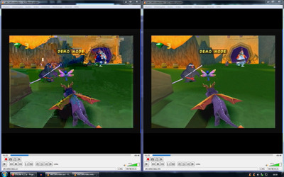

Reply 33 of 41, by anakin94
Thank you for your reply.
If i capture with the x264vfw codec to AVI it works fine.
But when i play the file in Windows Media Player or VLC i get every ~5 seconds artefacts.
When i remux the AVI file to a MKV file, then this will not happen.
Here is a screenshots, left is the original AVI file and on the right is the MKV remux.
236.15 KiB
2646 views
AVI / MKV comparision
With other codes it works without problems.
This is not a must have, but this would be super for the H.264 codec.

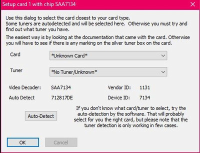

Reply 34 of 41, by marisol
Hello, i use windows 10 64bit
i have pci tv tuner
philips SAA713X hybrid capture device
with hardware id: ven_1131 dev_7134
but every time i open dscaler this don't recognize my pci card,
i have to select uknow and audio source
and after yes i see image and can capture
but i have to do this every time i open dscaler
this is what i see
39.49 KiB
2359 views
any way to add my model to dscaler
thanks
Reply 35 of 41, by darry
marisol wrote on 2021-05-08, 14:20:
Hello, i use windows 10 64bit i have pci tv tuner philips SAA713X hybrid capture device with hardware id: ven_1131 dev_7134 […]
i have pci tv tuner
this is what i see
thanks
I believe that you can add it yourself by modifying the SAA713xCards.ini file in the program's directory . Instructions are provided at the beginning of the file .

Reply 37 of 41, by darry
marisol wrote on 2021-05-08, 17:16:
this is SAA713xCards.ini , but don't understand how which change
Spoiler

If everything works for you with default settings and you do not want/need to bother with finding proper input, GPI, etc values , but just want to get rid of that detection screen, you could try to insert
[Unknown]
DeviceID = 0x7134
AutoDetectID = 0x712817DE
starting at line 197 in the file .
No guarantees, best of luck .
