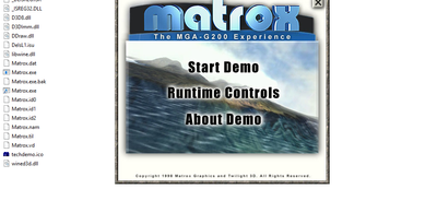

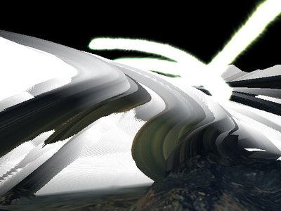

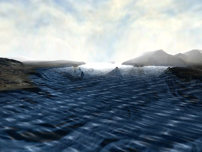

CoolGamer wrote:
Matrox G200 Tech Demo (DX5) http://soggi.eu/video-cards/tech-demos.htm http://toastytech.com/files/Is3Engine.zip […]
This G200 demo probably uses a simpler version of the same engine that G400 demo uses. You need to use 32bit version of InstallShield3 setup32.exe to install it. It has a GPU name check which can be easily turned off using Ollydbg, but after that it starts giving initialization errors.
I got around the initialization error. Unfortunately with the current dgVoodoo WIP it only shows the menu but closes when you click the "Start" button.
However using Wined3d allows launching the actual demo.
371.78 KiB
2324 views
571.41 KiB
2324 views
There is no video of this demo on the internet so its visuals are a big mystery.
Not anymore.
https://youtu.be/FEy377dApaI

Reply 23 of 103, by teleguy
DDrawCompat also works.

Wow, G200 tech demo video looks great. I am glad that it did not turn out to be a simple demo with a 3D soda can on a table 😀 . Water shaders look great for a DX5 demo. It provides a good opportunity to fix DX5 related bugs in dgVoodoo WIP31.
I had no luck getting the G200 tech demo to work on my Windows 7 Ultimate 64bit OS via WineD3D or via DDrawCompat. I also tried Application Compatibility Toolbox. Application just hangs when I use WineD3D. DDrawCompat gives a Visual C++ function call error.

I've done a few more tests and these are my findings:
Windows XP (Virtual Machine):
WineD3D (1.7.52 or older) ->working ( http://downloads.fdossena.com/Projects/WineD3 … dows_1.7.52.zip )
DDrawCompat ->incompatible
Win 95 mode ->not working
Windows 7 64 bit / R9 290X:
WineD3D (multiple versions)->exe does nothing or keeps eating up more and more ram
DDrawCompat ->working
Win 95 mode/ no wrapper ->working
Windows 10 64 bit / R9 290X:
WineD3D ->working
Win 95 mode / no wrapper ->working
Windows 10 64 bit / GTX 1070:
DDrawCompat (test release) ->exe closes itself
DDrawCompat (0.2.1) ->Visual C++ error
Win 95 mode / no wrapper ->Visual C++ error
Win 95 mode + DDrawCompat ->working at last!
EDIT: I was able to make WineD3D work on my Windows 7 AMD and my Windows 10 Nvidia system by adding Mesa's Opengl32.dll to the demo folder and selecting "backbuffer" as "Offscreen Rendering" mode in wined3dcfg.cpl but performance is poor.
https://www.dropbox.com/s/4cp63htqn5eyeon/opengl32.zip?dl=0
wined3dcfg.zip
25.36 KiB
165 downloads

There's something really awful about that G200 Tech Demo. Can't be fixed by dgVoodoo, needs some serious patching. Sorry, my DllMain patch alone won't do, it crashes in D3D11.dll. Seems to be making DDraw calls on DLL_THREAD_ATTACH, disabling thread notifications just makes it exit with code 1. Seems to be working natively with teleguy's patched exe alone + Win10 + Win95VersionLie from Compatibility Administrator + NVIDIA GTX 750 Ti driver version 368.81.
G400 Tech Demo doesn't work here, crashes with dgVoodoo or without when I launch it, except without dgVoodoo crashpoint is ntdll.dll and the main executable otherwise.

Teleguy, thanks for your help. I got the G200 demo to work on my Windows 7 Ultimate 64bit os with Nvidia GT230M. Test results are below.
Test Results:
Without a compatibility profile I could not get the G200 tech demo to work no matter what I tried.
profile 1 on its own, application crashes with Visual C++ function call error
profile 1 + DDrawCompat works!!! (This is the best option for me at the moment)
profile 1 + wined3d works!!! (but crashes at exit when I press the Escape key)
Profile 1 + winded3d + wined3dcfg.cpl + opengl32 works but slow.
There is a problem with Profile 2, it gives an error during installation that says "Error could not open SDB". I think the SDB file got corrupted somehow. If you fix it, I will edit this post and add the test results for Profile 2.
Reply 39 of 103, by teleguy
Thanks for the test results. The only difference between the profiles is that with profile 2 Matrox.exe runs in admin mode. This was required on my Nvidia system, otherwise the graphics would leave a trail behind, see screenshot. But since you don't have that problem it's not really necessary. And of course users can easily enable that mode themselves if needed.
