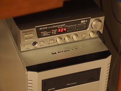

I think it's better than all SC modules except for the SC-8850. It has samples for, and can "emulate," the SC-55/mkII, SC-88, SC-88Pro, SC-8820. If I remember correctly, the internal mixing rate is higher than the SC-8850's 32khz for cleaner sound. And it has USB audio and SPDIF & toslink in/out.
The only downside is no LCD screen; I use mine daily.
