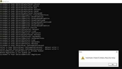

Reply 644 of 892, by KainXVIII
Tomb Raider 3 (steam ver) still not working, any ideas why?

Reply 648 of 892, by Gaeleath
Hello, I browsed through the thread but haven't found a solution that works yet. I'm having problems launching Tomb Raider 2. It seems to open with the following:
Changing compability for S:\Program Files (x86)\Steam\steamapps\common\Tomb Raider (II)\Tomb2.exe WinXPSp2

Then it seems like it's going to load because a pitch black screen comes up on the screen, off to the side and it can't be moved, and then both windows close down and nothing else happens. I don't know what I'm doing wrong here. T.T Any help would be greatly appreciated. Running the Steam version on Windows 10 64bit.
Reply 649 of 892, by Peixoto
Are you guys using the multipatch ??
DudemanBroski wrote:
I might be a bit of a dummyhead, but should Unreal run in fullscreen with this patch? For me the game runs in weird fullscreen / windowed hybrid mode and try as I might, I cannot make it run in real fullscreen. Is it a limitation in the patch or am I making something really, really wrong? I am using 227i patch also, is this patch incompatible with it? Might that be causing the problem?
You have to configure the game to run in fullscreen beforehand
Reply 650 of 892, by KainXVIII
Peixoto wrote:
Yes.
UPD - i just checked, Steam version already have identical files that multipatch have (already patched?)

Succeeded to hook IDirectDrawPalette::SetEntries
Succeeded to hook IDirectDrawPalette::GetEntries
Succeeded to hook IDirectDrawSurface::QueryInterface
Show last 67 lines
Succeeded to hook IDirectDrawSurface4::Lock
Succeeded to hook IDirectDrawSurface4::UnLock
Succeeded to hook IDirectDrawSurface::UnLock
Succeeded to hook IDirectDrawSurface4::Blt
Succeeded to hook IDirectDrawSurface4::Bltfast
Succeeded to hook IDirectDrawSurface4::GetDC
Succeeded to hook IDirectDrawSurface4::ReleaseDC
Succeeded to hook IDirect3DTexture2::Release
Succeeded to hook IDirect3DTexture2::Load
Succeeded to hook IDirect3DDevice3::SetTexture
IDirectDrawSurface4::Lock is already hooked
IDirectDrawSurface::UnLock is already hooked
IDirectDrawSurface4::UnLock is already hooked
IDirectDrawSurface4::Blt is already hooked
IDirectDrawSurface::QueryInterface is already hooked
Succeeded to hook IDirect3DTexture2::GetHandle
Succeeded to hook IDirect3DDevice2::SetRenderState
Succeeded to hook IDirect3DTexture::Load
Succeeded to hook IDirect3DTexture::GetHandle
Succeeded to hook IDirect3DTexture::Release
Succeeded to hook IDirect3DDevice::Execute
Succeeded to hook IDirectDraw::SetCooperativeLevel
Failed to hook IDirectDraw2::SetCooperativeLevel - detours error 1
Failed to hook IDirectDraw4::SetCooperativeLevel - detours error 1
Succeeded to hook IDirectDrawSurface::flip
Succeeded to hook IDirectDrawSurface4::GetAttachedSurface
Succeeded to hook IDirectDrawSurface4::EnumAttachedSurfaces
Succeeded to hook IDirectDrawSurface::GetAttachedSurface
Succeeded to hook IDirectDrawSurface::EnumAttachedSurfaces
Succeeded to hook IDirect3DDevice3::BeginScene
Succeeded to hook IDirect3DDevice3::DrawPrimitive
Succeeded to hook IDirectDrawSurface4::blt
Succeeded to hook IDirectDrawSurface2::blt
Succeeded to hook IDirectDrawSurface::blt
Succeeded to hook IDirectDrawSurface4::lock
Succeeded to hook IDirectDrawSurface4::Unlock
Succeeded to hook IDirectDrawSurface::Unlock
Succeeded to hook IDirectDrawSurface2::lock
Succeeded to hook IDirectDrawSurface2::Unlock
ptr 191665696 use 191518400 sz 17120 hwnd 191518400
ptr 191652832 use 191518304 sz 4252 hwnd 191518304
ptr 191519544 use 191517848 sz 652 hwnd 191517848
ptr 191520152 use 191518160 sz 948 hwnd 191518160
Succeeded to unhook IDirect3DTexture::Release
ptr 191800472 use 191518136 sz 17120 hwnd 191518136
ptr 191508640 use 191517848 sz 4252 hwnd 191517848
ptr 191505112 use 191517848 sz 652 hwnd 191517848
ptr 191505096 use 191517800 sz 948 hwnd 191517800

I tried Peixoto patch for Tomb Raider 2 and the fixes were not something that interested me . Does any one know why after I ran this file that it now overrides my Joy2key settings? Ive tried reinstalling the game from Steam and still wont work. Ive deleted the patch program and nothing. How does it keep that setting to override? Ive looked through this forum and someone else was asking the same thing. I couldn't understand the reply to fix though . any insight would be appreciated . Thank you

I`m done with alice, but it would be easy to modify the alice script and implement it. In the future i will add some documentation for people who are able to do that kind of stuff
unkles wrote on 2019-12-31, 05:41:
That`s probably because the program sets winxpsp2 compatibility for the game. Try to set winxpsp2 compatibility for joy2key as well
