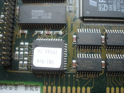

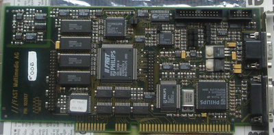

FAST Multimedia AG:
1.75 MiB
1149 views
FAST Multimedia AG
2.39 MiB
1149 views
FAST details
The attachment DSC07318.JPG is no longer available
There is a sticker on the back with reference to FAST SMII 22a BMK 102858 21362 43

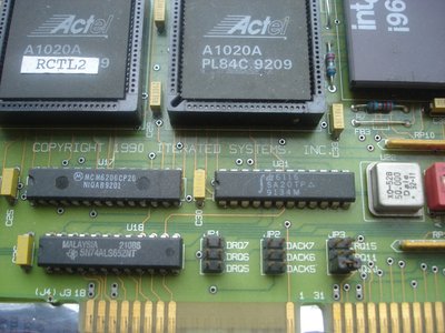

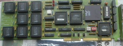

Iterated Systems Card:
2.14 MiB
1149 views
Iterated Systems Detail
2.39 MiB
1149 views
Iterated Systems
    2.05 MiB
    1149 views

Reply 1 of 10, by keropi
Judging from the SAA7195 chip this is a video capture card, probably the video connections are on a missing breakout cable. Does it have a VGA port that works? Could also double as a vga.
From the datasheet:
SAA7195A is the core device used in many multimedia PC add-on cards that were designed to demonstrate the
performance of various desktop video chipset from Philips Semiconductors. Typical applications of these cards
are video display and capture in PC environment, image processing in medical and scientific equipment.
Reply 4 of 10, by yawetaG
Those cards don't replace the normal video card, you need a pass-through video cable so the video you are capturing can be displayed on your monitor (and of course the special software associated with the card). The FAST (known capture card manufacturer) card might have an optional daughterboard for MPEG de/encoding...
Mr-486 wrote:
Video capture on a 486 must have been a fragile affair?
Meh, no, the card does most of the job, plus you were kinda expected to use SCSI hard disks instead of IDE. Just don't expect resolutions above 320x200...
Reply 6 of 10, by jade_angel
Note the i960 CPU on that card - that's got almost as much oomph as a 486 would have had, maybe more.
