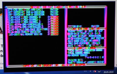

Deunan wrote:
As for you new mobo, I can see A LOT of corrosion near the ISA slots, the '245, keyboard socket and the RTC. There's no way data signals D0-D7 are still working on this thing.
Considering the 008 chip state as well I'd say this is parts donor board at this point. I mean, it coudl be repaired, but is it really worth rewiring half the PCB?
Hehe, I agree to your observation, but "never give up". I think its not as bad as it looks like. Its powering up reliably, Supersoft is alo running with lots of errors... 😲

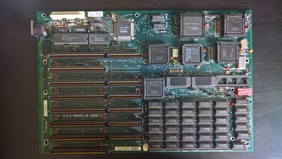

So... I'm having RAM issues while trying to set up another Suntac board. This particular board supports SIPP memory, but since I only have 256kb SIPP modules, I'm trying to make it work with 1Mb SIMM modules in SIMM holders inserted into the SIPP slots.
The DIP switches for memory are set correctly on the mobo and it reports the correct memory size (4Mb). It posts without problem, but when I run a memory test in Checkit, I get lots of errors. I removed the SIMM modules from their holders and put them into a 386 board to test, and Checkit doesn't find any error so I assume the SIMMS are ok.
On the Suntac mobo there are 3 jumpers next to the DIP sockets: RAS, CASL, and CASH. I'm thinking maybe they're set incorrectly and that's why Checkit is finding errors? I've tested the 256kb SIPP modules and the Checkit test runs ok - it only happens with the 1M SIMMs (which are all 9 chip modules).
Any ideas?

Reply 122 of 196, by Deksor
I don't think simm slots put in sipp slots is a very reliable way of using RAM, but I might be wrong.
Reply 123 of 196, by MMaximus
I wasn't aware of the possibility until I stumbled upon this article - which I think was written by a vogons member.
It's true that the contact between the pins and the slots is less secure as there is more movement than when only using SIPPs in the SIPP slots, but I assume that as long as the motherboard sees all the RAM at POST, then this means that all pins are connected to the board...

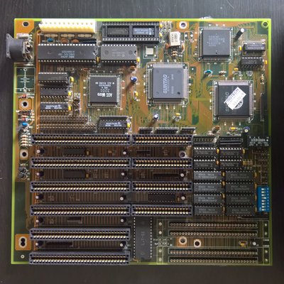

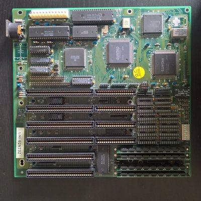

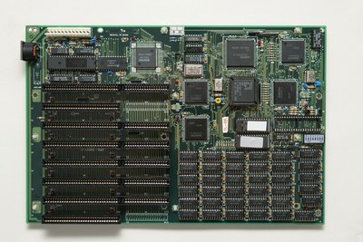

My collection of Suntac motherboards... all working perfectly fine. I had to add a small bodge on the backside of one of them because there was some dammage caused by something sharp and one of the traces was broken...

Two more...

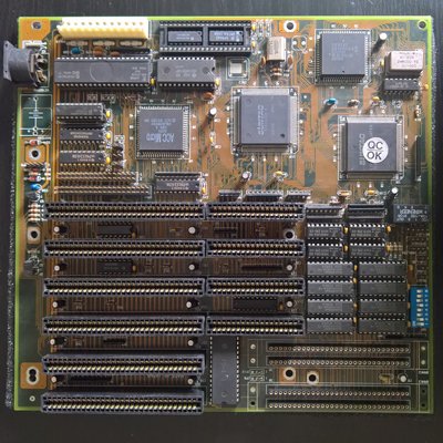

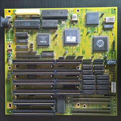

Got this one on the way(sellers pics) also a 20 MHz chips NEAT board. Looking forward to next week when I get to play around with this one.

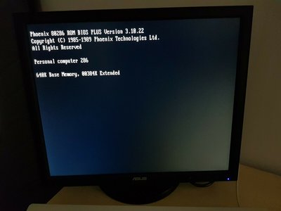

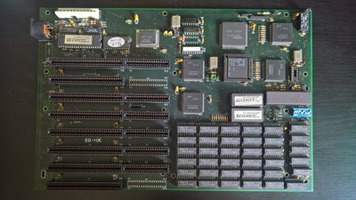

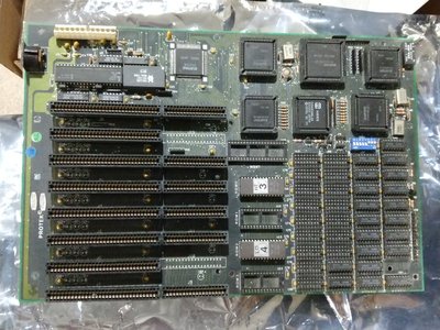

Reply 132 of 196, by dorkbert
Got this board a few months ago. Applied power and got no response; power supply fan spins, so there's no dead short on the board.
It didn't come with the processor, so there was a pretty good chance that it was dead to begin with. Have not done anything else with it since.
Nice board, all ICs on socket and spare ROM-sockets. Did you connect a speaker and did you hear anything?
If not, buy a POST-card from China first.
I would also verify the location of the 2 ROMs - maybe ROM0 and ROM2 are not the correct sockets? And most important (difficult to see on your photo): Do they have the correct orientation? Is the notch on the socket on the same side as on the IC?
Reply 136 of 196, by Predator99
dorkbert wrote:
yes, it looks like EPROMs are inserted backwards. I pulled them and they're reading all zeros. I'll need to see if any of the BIOS would work on this board.
Yes, then you have destroyed the ROMs after powering on. Any image uploaded in this thread should work.

Reply 138 of 196, by dorkbert
Predator99 wrote:
To be fair, it was probably blown when I got it. That said, I ordered some 27128s and dropped them in after programming them with Award 3.03 (no particular reason, just randomly selected one from many BIOSes posted to this thread) and got some activity on the diagnostic card... but still no video. The bad news is the new diag card has a few dead segments on the LED (do they even test these things before shipping them?) so I am getting some code that I am not sure if they're accurate.
edit: left the thing plugged in for half an hour and now I got video; CMOS is (as expected) dead, but otherwise it looks like it might just work...
Not sure why it didn't come up initially. Power supply issue maybe.
