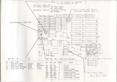

Scanned the Manual.
TCI Trident Computer Inc. Oct 01 1987
Suntac TCI EMS-286.pdf
1.83 MiB
251 downloads
Wiring diagrams are exactly the same I posted above.

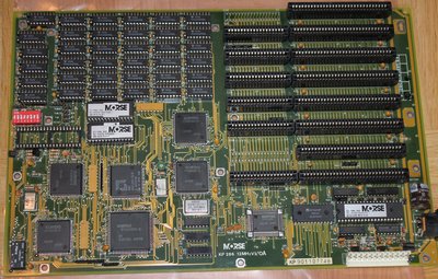

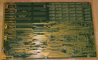

Next one 😀 From this lot:
Re: Bought these (retro) hardware today

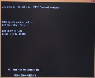

Believe it or not, it looks like new and working perfectly (as most other boards from this lot). Battery also in good shape. Seller made a bad photo with the board lying on the street.
It a MORSE KP-286
1.44 MiB
2413 views
1.26 MiB
2413 views

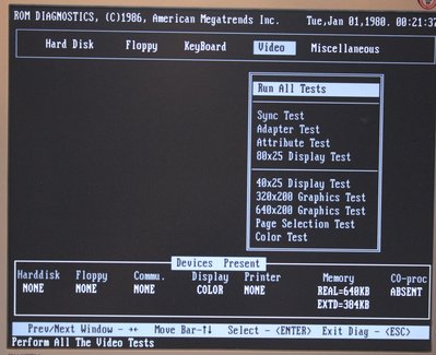

BIOS is again the AMI Diagnostic ROM...will post image file later.
03/20/89 ROM DIAGNOSTICS.(C)1987, American Megatrends Inc.All rights reserved. 1346 Oakbrook Drive, Suite 120,Norcross, GA 30093, Phone-(404)-263-8181.

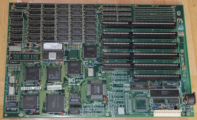

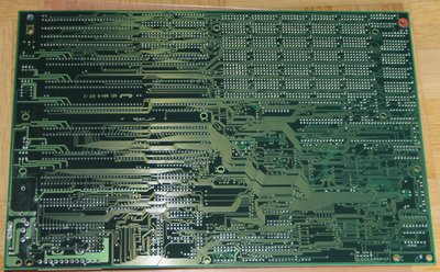

Next boards are from this lot
1.37 MiB
2345 views
1.09 MiB
2345 views

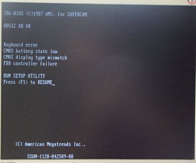

I have 3 of them running again in the meantime. The 4th one still stops on random error codes. They are labeled "SB-286" "SUP 1989 G". When taking a look at them they are the boards with the most features so far. They accept 3 differnt kinds of RAMs. And there even an (unpopulated) option for onboard parallel + serial ports.
Strange thing is: My keyboards do not fit. Seem to be non-standard DIN connector. Did not figure out the exact reason so far, but I assume the holes are smaller than usual.
225.78 KiB
2345 views
BIOS is AMI.
(C)AMI Date :-04/25/89 (C)1985-1989, American Megatrends Inc.
SSUN-1120-04/25/89-K0
1987 AMI, for SUPERCOM

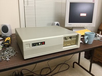

I am sure you saw my post over in the "What retro activity did you get up to today?" thread:

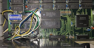

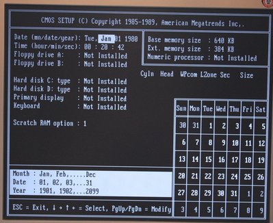

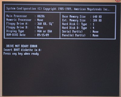

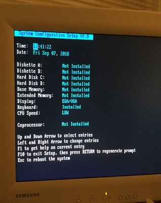

That manual you uploaded is the EXACT Suntac board that is in my beast and so super thanks for uploading it here!!! A weird thing with my Phoenix BIOS chips that are in this board is I have to manually type the amount of memory into the BIOS so it does not post with errors. Even though dip switches 6, 7 & 8 are set correctly (640K+384K Mode 3) and the memory counts up correctly in the post test you still have enter the memory values in manually in the BIOS. It was driving me crazy as the BIOS states to use the arrow keys to change the values and the numeric keypad does not work in the BIOS either so it took me awhile to figure out: 1.) You have to type the memory values in manually 2.) You can only use the top row number keys on the keyboard.
Grrr... 🤣 - Anyway on my way to getting this beast fully operational.

Thanks for the upload again! I have splitted your image in the HO/LI portions and tested in my board. It powers up, but I am not able to enter Setup. Every time I press F2 it reboots...
I assume the image is not complete and the file needs to be 128kb in size. Its similar to the AMI Diagnostic ROM I posted above. This one powers up with the 64kb part only, but you are not able to enter the diagnostic menu.

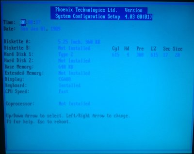

Ups..had an idea where the mistake is. Had to switch the jumper on the Mainboard from 27128 to 27256. Now it reads the whole chip and I can enter Setup:
612.1 KiB
2289 views
No BIOS at E000...
Also attach the Hi/Lo files of your image for programming.
