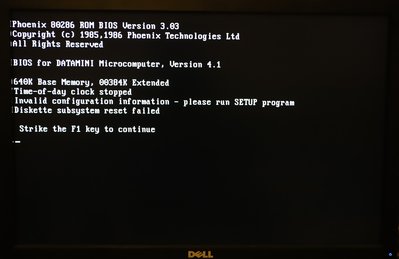

BIOS dumped ! (I don't know which one is the high chip and which one is the low chip, so I took note of what sticker is on it compared to the photo.)

Type 47 is just another preset drive unfortunately.
Also, I've discovered something else. I had an intuition of something, so I removed the controller card just to look underneath the mfm/floppy cables, and guess what I've seen ? Unpopulated battery spot ! So now I'm almost 100% MMaxmimus has the same board as me, just that instead of the MC146818AP chip, there's a DALLAS battery RTC chip.
I've also the manuals of that computer, and the motherboard is documented, so I might scan that someday.

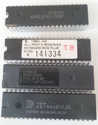

As in the latest board the keyboard BIOS was damaged by corrosion (top on picture) I tested some other replacements I had in spare. I think they are from 286-486 class PCs. Also took one from anoher 386 board, not on picture.
All work without problem. They seem to be interchangable between CPU classes and BIOS manufacturers.
Without Keyboard BIOS post card stops at "02 01".

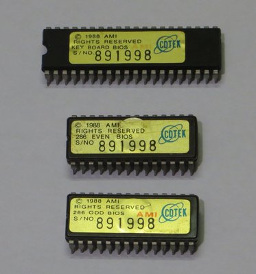

Here's the BIOS, both EPROMs and a combined version for emulators and whatnot.

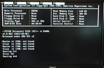

Reply 89 of 196, by Predator99
I already can confim your ROMs are OK, thanks!

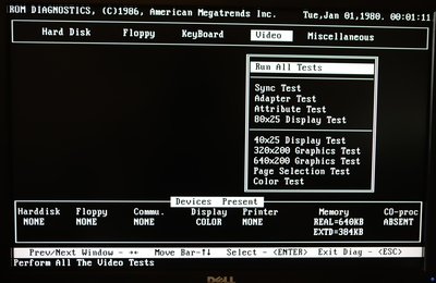

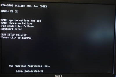

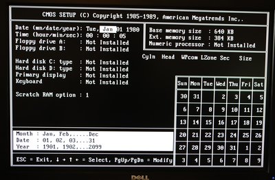

And: Your combined image is the 1st one that runs in PCem...! "AMI 286 clone" accepts it. I tried most of my images but none worked. Maybe I made a mistake whith combining the odd/even? Strange, will verify this.
But screenshots are from real hardware:

Reply 90 of 196, by Deunan
Can you test something for me? With this BIOS installed, remove the 8042 keyboard controller and boot the system, with test card in ISA slot. What code it stops at and do you get any beeps?
Reply 91 of 196, by Predator99
Sure. Thats interesting. After removing the 8042 the system came up with your BIOS.
A message is displayed on the VGA:
8042 GATE-A20 ERROR
SYSTEM HALTED
