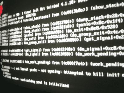

I downloaded the RPi2 image from here and wrote it onto my 16GiB SDHC card (SanDisk Ultra) using Win32DiskImager.
So far so good. When I powered on the Pi, everything happened like usual. The rainbow-coloured screen lighted up and the Pi booted from the card.
.. 'til it stopped with a kernal panic.
What did I do wrong ? Can anyone help or give me a hint, please ?
I know this is no support forum, and the project is still in development, but I have no idea where else to ask..
I'm using a stock Raspberry Pi 2 with composite monitor, a simple USB-MIDI cable and mouse/keyboard.
I also tried booting w/ an USB audio adapter from Thrust.
Booting Raspbian also worked like a charm (using an 8GiB card), so I think the Pi is fine.
If someone can give me a hint, please respond. I'm thankful for any idea!
(PS: I hope it is okay to post in this category. I didn't like to pollute the original thread, but also wasn't sure where else to ask for help.)

Reply 1 of 10, by gdjacobs
The image uses the stock kernel and modules, but I believe I've made some changes in the config.txt and cmdline.txt files. You can mount the Raspbian SD card on another machine, copy the files, then mount the MUNT equipped SD card and copy the files to it. That will restore the sequence to stock.

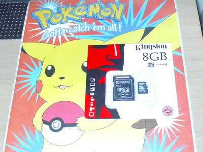

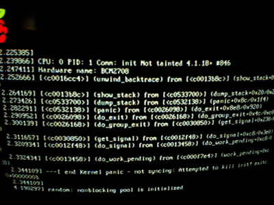

Okay, so my first card arrived a short while ago. It's a branded article (Kingston).
My kernel panic problem still persists, though. I'm still having the same issue with the new card..
So perhaps it is not related to the cards and I should look for another cause (?).
But before I do, I think it is best to wait for the other card, as well and give it another try.
Anyway, I just wanted to keep you informed. :)

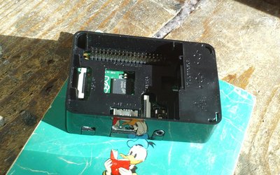

Hi again, just found out there are two revisions of the RPi2: Pi2 Model B v1.1 and new v1.2 😳
Which one do you use ?
Reply 8 of 10, by gdjacobs

Reply 9 of 10, by Jo22
gdjacobs wrote:
Not sure, I'll have to look.
Thanks, I think I've found out the culprit. The PCB reads Raspberry Pi B+ v1.2. Seems like I got the B+ instead of Pi 2..
Visually they are quite similar and since I have never taken the case apart, I didn't notice (got it as complete "Pi 2" set).
Oh, well.. But so is life. *sigh* Anyway, thank you very much for your help and patience!
