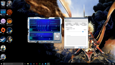

So just to be clear, and thanks for answering, not enabling EAX in the mixer will not disable EAX in games even though I do notice a very noticeable difference in audio with it turned on in EAX games like Quake 4.
Here is a picture of what I am looking at.

Reply 22 of 23, by lagonauta
cyclone3d is right, but only on Entertainment Mode this is true, while on Music Creation Mode this is totally customisable.
On Game Mode, disabling EAX on the panel disables any EFX/EAX used by OpenAL. Enabling EAX on the control panel does not enable system-wide effects on this mode.
By the way, what drivers are you using on Windows 10 for your Fatality Pro? Does it cause "high" cpu usage on audiodg.exe when recording or playing, compared to onboard? Mine does (especially when recording) , but I am not sure if this is an firmware problem or something...

I am using the Daniel_k Drivers http://danielkawakami.blogspot.com/2017/01/sb … rt-pack-40.html and I have not noticed a high CPU usage, but I have an i5 6500 so 4 cores might be balancing it. I figured out the EAX stuff late last night through old fashioned trial and error. Creative has to be the worst company on the planet when it comes to documentation about their products. I could only ever find marketing materials.
