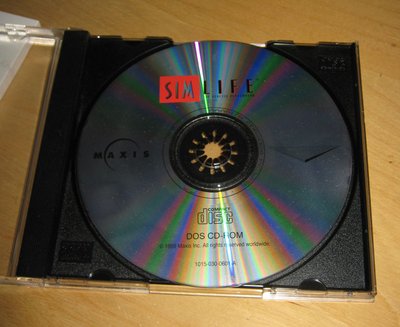

Reply 29 of 37, by yawetaG
95DosBox wrote:
yawetaG wrote:
Thanks. I'll try that.
Edit: Well, it was set to SML /640 /S6, changed that to SML /640 /S1. Tested that, and it still says "You have installed SimLIfe with NO sound support". So I guess it's missing files on the CD-ROM related to sound.
The 800 option will get you 800x600 resolution. I think it should work without any additional drivers. I tried it in DOSBOX and it works. Can't say much about the sound for internal PC speaker but the SB option is working.
It isn't working for me because the CD-ROM I have (picture below) appears to be missing all files related to sound...and (obviously) if the sound files are absent, I can select whatever I want in the installation program, but it won't work.
Could you check for me that there's a folder named "SOUND" present on your installation? If so, could you please put that folder in a ZIP file and upload it somewhere?
    94.46 KiB
    1792 views
YawetaG there is no sound folder. Can you do a directory listing of all the files on the CDrom and paste them here in wide format?

Reply 32 of 37, by yawetaG
95DosBox wrote:
There is no sound folder. Can you do a directory listing of all the files on the CDrom?
Okay, here goes:
CPL4DAT._
CPL4NDX._
DESERT._
FANCIFUL._
FILTER._
FONT._
GAMES._
GAMETEXT._
HERBIVOR._
INFO.EXE
INSTALL.EXE
INSTALL.MXS
MAP._
MAXIS.CIM
POSTCARD.CIM
PREDATOR._
PREHIST._
README.TXT
SML._
TEMPERAT._
TROPIC._
WATER._
ZOOS._
Reply 33 of 37, by 95DosBox
yawetaG wrote:
Okay, here goes: […]
Okay, here goes:
CPL4DAT._
CPL4NDX._
DESERT._
FANCIFUL._
FILTER._
FONT._
GAMES._
GAMETEXT._
HERBIVOR._
INFO.EXE
INSTALL.EXE
INSTALL.MXS
MAP._
MAXIS.CIM
POSTCARD.CIM
PREDATOR._
PREHIST._
README.TXT
SML._
TEMPERAT._
TROPIC._
WATER._
ZOOS._
Looks like you are missing some directories but I don't think they are sound related.
Also I don't see your file sizes listed.
Go to Command Prompt and type:
C: (or whatever the drive letter is where your SIMLIFE is stored)

Reply 34 of 37, by yawetaG
Yeah, sorry about the file sizes, but my internet connected machine isn't a DOS-capable PC but a Mac, so I just copied the directory listing.
Also, you asked me for a file listing from the CD, which are the compressed installation files, not the installed files. Anyway, I compared your listing with the one on my Win98SE machine, and I've got the following (copied by hand):
Additional files:
info.exe 27,025 (Maxis system information utility)
postcard.cim 15,341 (registration card I think)
maxis.cim 67,557
Files with different file sizes:
install.exe 117,110
sml.exe 657,559
games.txt 6,562
simlife.bat 11
readme.txt 15,311
cpl4life.dat 1,297,071
cpl4life.ndx 10,164
Missing files:
WINDOWS.800 (SVGA option?)
map.x32
Your files are also a year newer (1996) than the year printed on my CD (1995). So it looks like your version is a different (bugfixed?) version.
