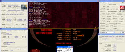

580.62 KiB
703 views
^Hope this answers the first part of your question 😀
As for the other part : Compatibility lies in drivers, and not hardware itself.
Some games/programs can't work on new drivers, and that's with the same GPU used for both.
Reply 3 of 5, by pentiumspeed
Very nice, what's OS? This is a board with VIA chipset (socket 775?), I had rather bad experience with this chipset on socket 462. Did VIA made other chipsets that good for different CPUs other than AMD?
I was thinking about XP or using windows 7 32bit.
Cheers, pentiumspeed
Great Northern aka Canada.
Reply 4 of 5, by agent_x007
Windows XP SP3 (fully Updated).
It uses VIA PT-880 Ultra chipset (yes, a LGA 775 board), and I like it.
It has few quirks, but in test system it worked fine (+ having AGP/PCI-e/PCI & DDR1/DDR2 & IDE/SATA - is really convenient 😁).
In general, VIA chipsets are low budget stuff, so not performance monsters, and not best compatibility. BUT they can do what others can't 😀
