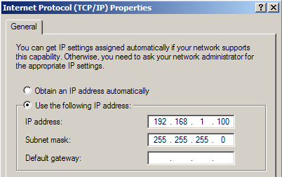

@Sammy, you could accomplish the same thing by going into the system you don't want to have internet access, assign it a static IP on your LAN, and simply delete the gateway:
11.13 KiB
1857 views
If the machine does not have a gateway defined, it can't get to the outside world.
